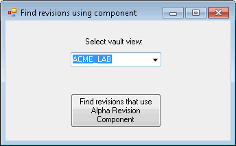

This example shows how to find the revision numbers using the revision number component named Alpha Revision Component.

'  6. Create a form similar to the form shown above and change:
'     a. Label to VaultsLabel.
'     b. Combo box to VaultsComboBox
'     c. Button to FindRevisionsButton.

'  1. Displays a dialog.
'  2. Select a vault.
'  3. Click the Find revisions that use Alpha Revision Component button.
'  4. Prints the names of the revision numbers using the revision number
'     component named Alpha Revision Component to the Immediate window.
'  5. Examine the Immediate window.
'  6. Close the dialog.
