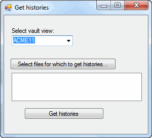

// Postconditions:
//  1. Displays the Get histories dialog box.
//     a. Select a vault view.
//     b. Click Select files for which to get histories.
//     c. In the Select File dialog:
//        1. Select one or more checked-in vault files.
//        2. Click Open.
//        3. Updates all version comments for the selected files to
//           "New comment".
//     d. Click Get histories.
//     e. Displays a message box for each history item.
//     f. Observe the updated version comments.
//     g. Click OK to close each message box.
