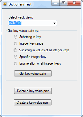

' Postconditions:
'  1. Displays a dialog.
'  2. Select a vault view.
'  3. Click Substring in key.
'  4. Click Get key-value pairs.
'     a. Displays a message box with all key-value pairs in the dictionary where
'        string key contains "at".
'     b. Click OK.
'  5. Click Integer key range.
'  6. Click Get key-value pairs.
'        integer keys are in the range, 13-88.
'     b. Click OK.
'  7. Click Substring in values of all integer keys.
'  8. Click Get key-value pairs.
'        value contains "three".
'     b. Click OK.
'  9. Click Specific integer key.
' 10. Click Get key-value pairs.
'     a. Displays a message box with the value for key, 77.
'     b. Click OK.
' 11. Click Enumeration of all integer keys.
' 12. Click Get key-value pairs.
'     a. Displays a message box with all integer key-value pairs in the dictionary.
'     b. Click OK.
' 13. Click Delete a key-value pair.
'     a. Displays a message box notifying that key, 2, is removed.
'     b. Click OK.
' 14. Click Create a key-value pair.
'     a. Displays a message box notifying that key, 2, is created.
'     b. Click OK.
' 15. Close the dialog.

        Me.RadioButton4 = New System.Windows.Forms.RadioButton()
        Me.RadioButton5 = New System.Windows.Forms.RadioButton()
        Me.Button1 = New System.Windows.Forms.Button()
        Me.GroupBox1 = New System.Windows.Forms.GroupBox()
        Me.GroupBox1.SuspendLayout()
        Me.SuspendLayout()
        'VaultsComboBox
        Me.VaultsComboBox.FormattingEnabled = True
        Me.VaultsComboBox.Location = New System.Drawing.Point(20, 39)
        Me.VaultsComboBox.Name = "VaultsComboBox"
        Me.VaultsComboBox.Size = New System.Drawing.Size(169, 21)
        Me.VaultsComboBox.TabIndex = 1
        'Label1
        Me.Label1.AutoSize = True
        Me.Label1.Location = New System.Drawing.Point(19, 23)
        Me.Label1.Name = "Label1"
        Me.Label1.Size = New System.Drawing.Size(91, 13)
        Me.Label1.TabIndex = 2
        Me.Label1.Text = "Select vault view:"
        'Button5
        Me.Button5.Location = New System.Drawing.Point(40, 272)
        Me.Button5.Name = "Button5"
        Me.Button5.Size = New System.Drawing.Size(132, 23)
        Me.Button5.TabIndex = 7
        Me.Button5.Text = "Delete a key-value pair"
        Me.Button5.UseVisualStyleBackColor = True
        'Button7
        Me.Button7.Location = New System.Drawing.Point(39, 312)
        Me.Button7.Name = "Button7"
        Me.Button7.Size = New System.Drawing.Size(132, 23)
        Me.Button7.TabIndex = 9
        Me.Button7.Text = "Create a key-value pair"
        Me.Button7.UseVisualStyleBackColor = True
        'RadioButton1
        Me.RadioButton1.AutoSize = True
        Me.RadioButton1.Location = New System.Drawing.Point(30, 19)
        Me.RadioButton1.Name = "RadioButton1"
        Me.RadioButton1.Size = New System.Drawing.Size(100, 17)
        Me.RadioButton1.TabIndex = 11
        Me.RadioButton1.Text = "Substring in key"
        Me.RadioButton1.UseVisualStyleBackColor = True
        'RadioButton2
        Me.RadioButton2.AutoSize = True
        Me.RadioButton2.Location = New System.Drawing.Point(30, 42)
        Me.RadioButton2.Name = "RadioButton2"
        Me.RadioButton2.Size = New System.Drawing.Size(108, 17)
        Me.RadioButton2.TabIndex = 12
        Me.RadioButton2.TabStop = True
        Me.RadioButton2.Text = "Integer key range"
        Me.RadioButton2.UseVisualStyleBackColor = True
        'RadioButton3
        Me.RadioButton3.AutoSize = True
        Me.RadioButton3.Location = New System.Drawing.Point(29, 65)
        Me.RadioButton3.Name = "RadioButton3"
        Me.RadioButton3.Size = New System.Drawing.Size(199, 17)
        Me.RadioButton3.TabIndex = 13
        Me.RadioButton3.TabStop = True
        Me.RadioButton3.Text = "Substring in values of all integer keys"
        Me.RadioButton3.UseVisualStyleBackColor = True
        'RadioButton4
        Me.RadioButton4.AutoSize = True
        Me.RadioButton4.Location = New System.Drawing.Point(30, 88)
        Me.RadioButton4.Name = "RadioButton4"
        Me.RadioButton4.Size = New System.Drawing.Size(118, 17)
        Me.RadioButton4.TabIndex = 14
        Me.RadioButton4.TabStop = True
        Me.RadioButton4.Text = "Specific integer key"
        Me.RadioButton4.UseVisualStyleBackColor = True
        'RadioButton5
        Me.RadioButton5.AutoSize = True
        Me.RadioButton5.Location = New System.Drawing.Point(30, 111)
        Me.RadioButton5.Name = "RadioButton5"
        Me.RadioButton5.Size = New System.Drawing.Size(169, 17)
        Me.RadioButton5.TabIndex = 15
        Me.RadioButton5.TabStop = True
        Me.RadioButton5.Text = "Enumeration of all integer keys"
        Me.RadioButton5.UseVisualStyleBackColor = True
        'Button1
        Me.Button1.Location = New System.Drawing.Point(30, 143)
        Me.Button1.Name = "Button1"
        Me.Button1.Size = New System.Drawing.Size(132, 23)
        Me.Button1.TabIndex = 16
        Me.Button1.Text = "Get key-value pairs"
        Me.Button1.UseVisualStyleBackColor = True
        'GroupBox1
        Me.GroupBox1.Controls.Add(Me.Button1)
        Me.GroupBox1.Controls.Add(Me.RadioButton5)
        Me.GroupBox1.Controls.Add(Me.RadioButton4)
        Me.GroupBox1.Controls.Add(Me.RadioButton3)
        Me.GroupBox1.Controls.Add(Me.RadioButton2)
        Me.GroupBox1.Controls.Add(Me.RadioButton1)
        Me.GroupBox1.Location = New System.Drawing.Point(10, 69)
        Me.GroupBox1.Name = "GroupBox1"
        Me.GroupBox1.Size = New System.Drawing.Size(249, 181)
        Me.GroupBox1.TabIndex = 17
        Me.GroupBox1.TabStop = False
        Me.GroupBox1.Text = "Get key-value pairs by:"
        'Form1
        Me.AutoScaleDimensions = New System.Drawing.SizeF(6.0!, 13.0!)
        Me.AutoScaleMode = System.Windows.Forms.AutoScaleMode.Font
        Me.ClientSize = New System.Drawing.Size(271, 366)
        Me.Controls.Add(Me.GroupBox1)
        Me.Controls.Add(Me.Button7)
        Me.Controls.Add(Me.Button5)
        Me.Controls.Add(Me.Label1)
        Me.Controls.Add(Me.VaultsComboBox)
        Me.Name = "Form1"
        Me.Text = "Dictionary Test"
        Me.GroupBox1.ResumeLayout(False)
        Me.GroupBox1.PerformLayout()
        Me.ResumeLayout(False)
        Me.PerformLayout()
