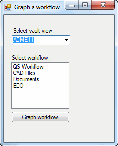

// Postconditions:
// 1. Displays the Graph a workflow dialog box.
// 2. Maximize the dialog box for the workflow graph.
// 3. Select a vault view.
// 4. Click a workflow.
// 5. Click Graph workflow
// 6. Graphs the selected workflow in the dialog box.
// 7. Close the Graph a workflow dialog box.

        private void InitializeComponent()
            this.VaultsLabel = new System.Windows.Forms.Label();
            this.VaultsComboBox = new System.Windows.Forms.ComboBox();
            this.GraphWorkflow = new System.Windows.Forms.Button();
            this.ListBox1 = new System.Windows.Forms.ListBox();
            this.Label1 = new System.Windows.Forms.Label();
            this.SuspendLayout();
            // VaultsLabel
            this.VaultsLabel.Anchor = ((System.Windows.Forms.AnchorStyles)((System.Windows.Forms.AnchorStyles.Bottom | System.Windows.Forms.AnchorStyles.Right)));
            this.VaultsLabel.AutoSize = true;
            this.VaultsLabel.Location = new System.Drawing.Point(13, 26);
            this.VaultsLabel.Name = "VaultsLabel";
            this.VaultsLabel.Size = new System.Drawing.Size(94, 13);
            this.VaultsLabel.TabIndex = 0;
            this.VaultsLabel.Text = " Select vault view:";
            // VaultsComboBox
            this.VaultsComboBox.Anchor = ((System.Windows.Forms.AnchorStyles)((System.Windows.Forms.AnchorStyles.Bottom | System.Windows.Forms.AnchorStyles.Right)));
            this.VaultsComboBox.FormattingEnabled = true;
            this.VaultsComboBox.Location = new System.Drawing.Point(16, 42);
            this.VaultsComboBox.Name = "VaultsComboBox";
            this.VaultsComboBox.Size = new System.Drawing.Size(121, 21);
            this.VaultsComboBox.TabIndex = 1;
            // GraphWorkflow
            this.GraphWorkflow.Anchor = ((System.Windows.Forms.AnchorStyles)((System.Windows.Forms.AnchorStyles.Bottom | System.Windows.Forms.AnchorStyles.Right)));
            this.GraphWorkflow.Location = new System.Drawing.Point(15, 199);
            this.GraphWorkflow.Name = "GraphWorkflow";
            this.GraphWorkflow.Size = new System.Drawing.Size(121, 23);
            this.GraphWorkflow.TabIndex = 5;
            this.GraphWorkflow.Text = "Graph workflow";
            this.GraphWorkflow.UseVisualStyleBackColor = true;
            this.GraphWorkflow.Click += new System.EventHandler(this.GraphWorkflow_Click);
            // ListBox1
            this.ListBox1.Anchor = ((System.Windows.Forms.AnchorStyles)((System.Windows.Forms.AnchorStyles.Bottom | System.Windows.Forms.AnchorStyles.Right)));
            this.ListBox1.FormattingEnabled = true;
            this.ListBox1.HorizontalScrollbar = true;
            this.ListBox1.Location = new System.Drawing.Point(15, 98);
            this.ListBox1.Name = "ListBox1";
            this.ListBox1.Size = new System.Drawing.Size(120, 95);
            this.ListBox1.TabIndex = 6;
            // Label1
            this.Label1.Anchor = ((System.Windows.Forms.AnchorStyles)((System.Windows.Forms.AnchorStyles.Bottom | System.Windows.Forms.AnchorStyles.Right)));
            this.Label1.AutoSize = true;
            this.Label1.Location = new System.Drawing.Point(13, 82);
            this.Label1.Name = "Label1";
            this.Label1.Size = new System.Drawing.Size(85, 13);
            this.Label1.TabIndex = 7;
            this.Label1.Text = "Select workflow:";
            // Form1
            this.AutoScaleDimensions = new System.Drawing.SizeF(6F, 13F);
            this.AutoScaleMode = System.Windows.Forms.AutoScaleMode.Font;
            this.ClientSize = new System.Drawing.Size(227, 262);
            this.Controls.Add(this.Label1);
            this.Controls.Add(this.ListBox1);
            this.Controls.Add(this.GraphWorkflow);
            this.Controls.Add(this.VaultsComboBox);
            this.Controls.Add(this.VaultsLabel);
            this.Name = "Form1";
            this.Text = "Graph a workflow";
            this.Load += new System.EventHandler(this.Form1_Load);
            this.ResumeLayout(false);
            this.PerformLayout();

        internal System.Windows.Forms.Button GraphWorkflow;
        internal System.Windows.Forms.ListBox ListBox1;
        internal System.Windows.Forms.Label Label1;
