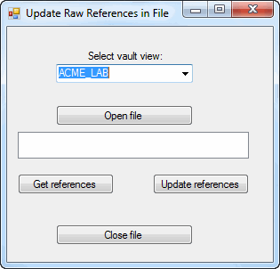

'  1. Displays the Update Raw References in File dialog box.
'  2. Select the vault view where the SOLIDWORKS assembly or
'     drawing document that you checked out in
'     Preconditions step 4 resides.
'  3. Click Open file.
'  4. Displays the Open a file dialog box.
'     a. Click the assembly or drawing document you checked
'        out in Preconditions step 4.
'     b. Click Open.
'     The opened file's path and file name appear
'     in the Update Raw References in File dialog box.

        Me.OpenButton.UseVisualStyleBackColor = True
        'GetButton
        Me.GetButton.Location = New System.Drawing.Point(12, 165)
        Me.GetButton.Name = "GetButton"
        Me.GetButton.Size = New System.Drawing.Size(108, 23)
        Me.GetButton.TabIndex = 3
        Me.GetButton.Text = "Get references"
        Me.GetButton.UseVisualStyleBackColor = True
        'UpdateButton
        Me.UpdateButton.Location = New System.Drawing.Point(164, 165)
        Me.UpdateButton.Name = "UpdateButton"
        Me.UpdateButton.Size = New System.Drawing.Size(108, 23)
        Me.UpdateButton.TabIndex = 4
        Me.UpdateButton.Text = "Update references"
        Me.UpdateButton.UseVisualStyleBackColor = True
        'CloseButton
        Me.CloseButton.Location = New System.Drawing.Point(55, 222)
        Me.CloseButton.Name = "CloseButton"
        Me.CloseButton.Size = New System.Drawing.Size(154, 23)
        Me.CloseButton.TabIndex = 5
        Me.CloseButton.Text = "Close file"
        Me.CloseButton.UseVisualStyleBackColor = True
        'FileListBox
        Me.FileListBox.FormattingEnabled = True
        Me.FileListBox.Location = New System.Drawing.Point(12, 118)
        Me.FileListBox.Name = "FileListBox"
        Me.FileListBox.Size = New System.Drawing.Size(260, 30)
        Me.FileListBox.TabIndex = 6
        'OpenFileDialog1
        Me.OpenFileDialog1.FileName = "OpenFileDialog1"
        Me.OpenFileDialog1.Multiselect = True
        Me.OpenFileDialog1.Title = "Open a file"
        'Form1
        Me.AutoScaleDimensions = New System.Drawing.SizeF(6.0!, 13.0!)
        Me.AutoScaleMode = System.Windows.Forms.AutoScaleMode.Font
        Me.ClientSize = New System.Drawing.Size(284, 264)
        Me.Controls.Add(Me.FileListBox)
        Me.Controls.Add(Me.CloseButton)
        Me.Controls.Add(Me.UpdateButton)
        Me.Controls.Add(Me.GetButton)
        Me.Controls.Add(Me.OpenButton)
        Me.Controls.Add(Me.VaultsComboBox)
        Me.Controls.Add(Me.Label1)
        Me.Name = "Form1"
        Me.Text = "Update References in File"
        Me.ResumeLayout(False)
        Me.PerformLayout()
