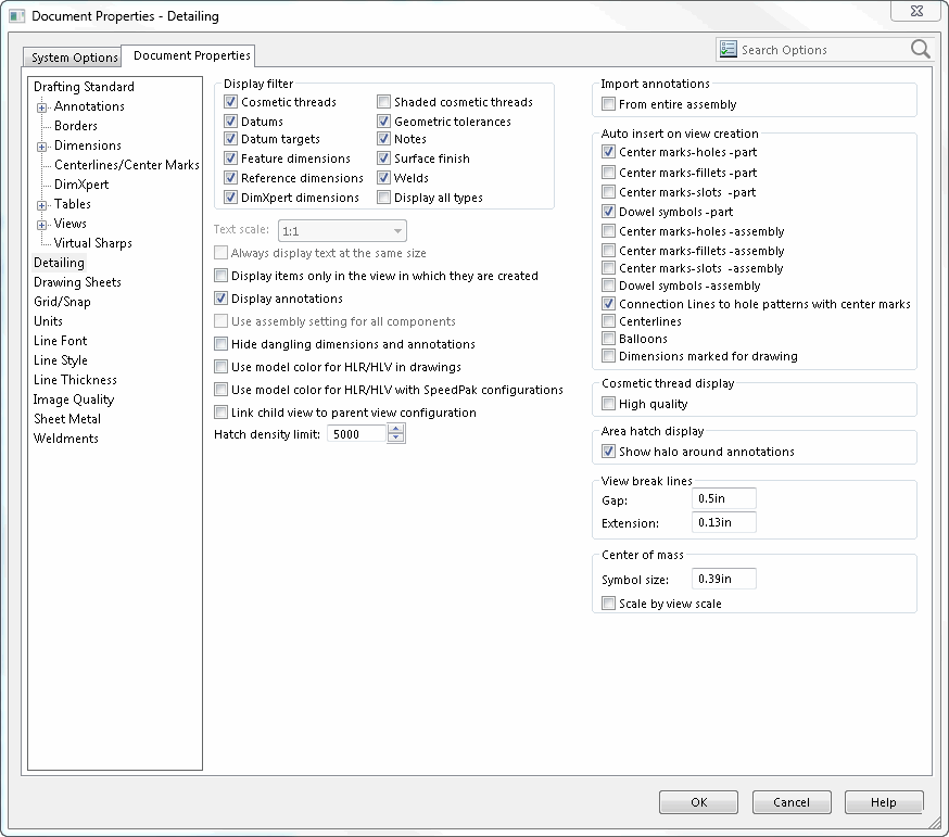

Setting |
Get/Set Methods |
Return Value or <Value> |
Comments |
Display filter - Cosmetic threads |
IModelDocExtension::GetUserPreferenceToggle(swUserPreferenceToggle_e.swDisplayCosmeticThreads,
swUserPreferenceOption_e.swDetailingNoOptionSpecified)
IModelDocExtension::SetUserPreferenceToggle(swUserPreferenceToggle_e.swDisplayCosmeticThreads,
swUserPreferenceOption_e.swDetailingNoOptionSpecified, <Value>) |
Boolean value |
Specifies whether to display cosmetic threads. Depends on swDisplayAnnotations
setting |
Display filter - Datums |
IModelDocExtension::GetUserPreferenceToggle(swUserPreferenceToggle_e.swDisplayDatums,
IModelDocExtension::SetUserPreferenceToggle(swUserPreferenceToggle_e.swDisplayDatums,
Boolean value |
Specifies whether to display datums. Depends on swDisplayAnnotations
setting |
Display filter - Datum targets |
IModelDocExtension::GetUserPreferenceToggle(swUserPreferenceToggle_e.swDisplayDatumTargets,
IModelDocExtension::SetUserPreferenceToggle(swUserPreferenceToggle_e.swDisplayDatumTargets,
Boolean value |
Specifies whether to display datum targets. Depends on swDisplayAnnotations
setting |
Display filter - Feature dimensions |
IModelDocExtension::GetUserPreferenceToggle(swUserPreferenceToggle_e.swDisplayFeatureDimensions,
IModelDocExtension::SetUserPreferenceToggle(swUserPreferenceToggle_e.swDisplayFeatureDimensions,
Boolean value |
Specifies whether to display feature dimensions. Depends on swDisplayAnnotations
setting |
Display filter - Reference dimensions |
IModelDocExtension::GetUserPreferenceToggle(swUserPreferenceToggle_e.swDisplayReferenceDimensions,
IModelDocExtension::SetUserPreferenceToggle(swUserPreferenceToggle_e.swDisplayReferenceDimensions,
Boolean value |
Specifies whether to display reference dimensions. Depends on swDisplayAnnotations
setting |
Display filter - DimXpert dimensions |
IModelDocExtension::GetUserPreferenceToggle(swUserPreferenceToggle_e.swDisplayDimXpertDimensions,
IModelDocExtension::SetUserPreferenceToggle(swUserPreferenceToggle_e.swDisplayDimXpertDimensions,
Boolean value |
Specifies whether to show DimXpert dimensions |
Display filter - Shaded cosmetic threads |
IModelDocExtension::GetUserPreferenceToggle(swUserPreferenceToggle_e.swDisplayShadedCosmeticThreads,
IModelDocExtension::SetUserPreferenceToggle(swUserPreferenceToggle_e.swDisplayShadedCosmeticThreads,
Boolean value |
Specifies whether to display cosmetic threads shaded or not |
Display filter - Geometric tolerances |
IModelDocExtension::GetUserPreferenceToggle(swUserPreferenceToggle_e.swDisplayGeometricTolerances,
IModelDocExtension::SetUserPreferenceToggle(swUserPreferenceToggle_e.swDisplayGeometricTolerances,
Boolean value |
Specifies whether to display geometric tolerances. Depends on swDisplayAnnotations
setting |
Display filter - Notes |
IModelDocExtension::GetUserPreferenceToggle(swUserPreferenceToggle_e.swDisplayNotes,
IModelDocExtension::SetUserPreferenceToggle(swUserPreferenceToggle_e.swDisplayNotes,
Boolean value |
Specifies whether to display notes. Depends on swDisplayAnnotations
setting |
Display filter - Surface finish |
IModelDocExtension::GetUserPreferenceToggle(swUserPreferenceToggle_e.swDisplaySurfaceFinishSymbols,
IModelDocExtension::SetUserPreferenceToggle(swUserPreferenceToggle_e.swDisplaySurfaceFinishSymbols,
Boolean value |
Specifies whether to display surface-finish symbols. Depends on swDisplayAnnotations
setting |
Display filter - Welds |
IModelDocExtension::GetUserPreferenceToggle(swUserPreferenceToggle_e.swDisplayWeldSymbols,
IModelDocExtension::SetUserPreferenceToggle(swUserPreferenceToggle_e.swDisplayWeldSymbols,
Boolean value |
Specifies whether to display weld symbols. Depends on swDisplayAnnotations
setting |
Display filter - Display all types |
See Comments |
See Comments |
Not currently available in SOLIDWORKS API |

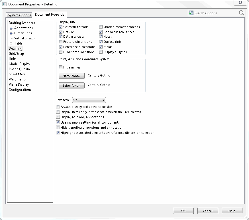

Point, Axis, and Coordinate System - Hide names |
IModelDocExtension::GetUserPreferenceToggle(swUserPreferenceToggle_e.swPointAxisCoordSystemHideNames,
IModelDocExtension::SetUserPreferenceToggle(swUserPreferenceToggle_e.swPointAxisCoordSystemHideNames,
Boolean value |
Specifies whether to hide names of points, axes, and coordinate systems
(parts and assemblies only) |
Point, Axis, and Coordinate System - Name font |
IModelDocExtension::GetUserPreferenceTextFormat(swUserPreferenceTextFormat_e.swPointAxisCoordSystemNameFontTextFormat,
IModelDocExtension::SetUserPreferenceTextFormat(swUserPreferenceTextFormat_e.swPointAxisCoordSystemNameFontTextFormat,
See ITextFormat
for valid font options |
To set font property values, implement ITextFormat, set the appropriate
ITextFormat member values, and pass the ITextFormat object in the API
set method (parts and assemblies only) |
Point, Axis, and Coordinate System - Label font |
IModelDocExtension::GetUserPreferenceTextFormat(swUserPreferenceTextFormat_e.swPointAxisCoordSystemLabelFontTextFormat,
IModelDocExtension::SetUserPreferenceTextFormat(swUserPreferenceTextFormat_e.swPointAxisCoordSystemLabelFontTextFormat,
See ITextFormat
Text scale - numerator |
IModelDocExtension::GetUserPreferenceDouble(swUserPreferenceDoubleValue_e.swAnnotationTextScaleNumerator,
IModelDocExtension::SetUserPreferenceDouble(swUserPreferenceDoubleValue_e.swAnnotationTextScaleNumerator,
Double value |
Specifies numerator for annotation text scale |
Text scale - denominator |
IModelDocExtension::GetUserPreferenceDouble(swUserPreferenceDoubleValue_e.swAnnotationTextScaleDenominator,
IModelDocExtension::SetUserPreferenceDouble(swUserPreferenceDoubleValue_e.swAnnotationTextScaleDenominator,
Double value |
Specifies denominator for annotation text scale |
Always display text at the same size |
IModelDocExtension::GetUserPreferenceToggle(swUserPreferenceToggle_e.swDisplayTextAtSameSizeAlways,
IModelDocExtension::SetUserPreferenceToggle(swUserPreferenceToggle_e.swDisplayTextAtSameSizeAlways,
Boolean value |
Specifies whether to display all annotations and dimensions at same
size regardless of zoom. Drawings have this option disabled and always
zoom the text height |
Display items only in the view in which they are created |
IModelDocExtension::GetUserPreferenceToggle(swUserPreferenceToggle_e.swDisplayOnlyInViewOfCreation,
IModelDocExtension::SetUserPreferenceToggle(swUserPreferenceToggle_e.swDisplayOnlyInViewOfCreation,
Boolean value |
Specifies whether to only display an annotation when model is viewed
in same orientation as when annotation was added |
Display annotations |
IModelDocExtension::GetUserPreferenceToggle(swUserPreferenceToggle_e.swDisplayAnnotations,
IModelDocExtension::SetUserPreferenceToggle(swUserPreferenceToggle_e.swDisplayAnnotations,
Boolean value |
Specifies whether to display annotations |
Use assembly setting for all components |
IModelDocExtension::GetUserPreferenceToggle(swUserPreferenceToggle_e.swDisplayAnnotationsUseAssemblySettings,
IModelDocExtension::SetUserPreferenceToggle(swUserPreferenceToggle_e.swDisplayAnnotationsUseAssemblySettings,
Boolean value |
For assemblies only. Specifies whether to display all annotations for
the assembly document, regardless of the setting in the individual part
documents |
Hide dangling dimensions and annotations |
IModelDocExtension::GetUserPreferenceToggle(swUserPreferenceToggle_e.swAnnotationDisplayHideDanglingDim,
IModelDocExtension::SetUserPreferenceToggle(swUserPreferenceToggle_e.swAnnotationDisplayHideDanglingDim,
Boolean value |
Specifies whether to hide dangling dimensions and annotations in drawings |
Highlight associated elements on reference dimension selection |
IModelDocExtension::GetUserPreferenceToggle(swUserPreferenceToggle_e.swDetailingHighlightElements,
IModelDocExtension::SetUserPreferenceToggle(swUserPreferenceToggle_e.swDetailingHighlightElements,
Boolean value |
Specifies whether to highlight elements associated with selected
reference dimensions; for parts and assemblies only |
Use model color for HLR/HLV in
drawings |
IModelDocExtension::GetUserPreferenceToggle(swUserPreferenceToggle_e.swUseModelColorInDrawings,
IModelDocExtension::SetUserPreferenceToggle(swUserPreferenceToggle_e.swUseModelColorInDrawings,
Boolean value |
Specifies whether to use model color
for hidden lines that are removed/visible |
Use model color for HLR/HLV with
SpeedPak configurations |
IModelDocExtension::GetUserPreferenceToggle(swUserPreferenceToggle_e.swUseSpeedpakModelColorInDrawings,
IModelDocExtension::SetUserPreferenceToggle(swUserPreferenceToggle_e.swUseSpeedpakModelColorInDrawings,
Boolean value |
for HLR/HLV with SpeedPak configurations; only
available when a drawing of an assembly is open |
Link child view to parent view
configuration |
IModelDocExtension::GetUserPreferenceToggle(swUserPreferenceToggle_e.swDetailingLinkParentViewConfiguration,
IModelDocExtension::SetUserPreferenceToggle(swUserPreferenceToggle_e.swDetailingLinkParentViewConfiguration,
Boolean value |
Specifies whether to link the child view
to parent view configurations |
Import annotations - From entire assembly |
IModelDocExtension::GetUserPreferenceToggle(swUserPreferenceToggle_e.swDetailingImportEntireAssemblyAnnotations,
IModelDocExtension::SetUserPreferenceToggle(swUserPreferenceToggle_e.swDetailingImportEntireAssemblyAnnotations,
Boolean value |
Specifies whether to import annotations from the entire assembly |
Auto insert on view creation - Center marks-holes -part |
IModelDocExtension::GetUserPreferenceToggle(swUserPreferenceToggle_e.swDetailingAutoInsertCenterMarksForHoles,
IModelDocExtension::SetUserPreferenceToggle(swUserPreferenceToggle_e.swDetailingAutoInsertCenterMarksForHoles,
Boolean value |
Specifies whether to automatically insert center marks for holes in parts |
Auto insert on view creation - Center marks-fillets -part |
IModelDocExtension::GetUserPreferenceToggle(swUserPreferenceToggle_e.swDetailingAutoInsertCenterMarksForFillets,
IModelDocExtension::SetUserPreferenceToggle(swUserPreferenceToggle_e.swDetailingAutoInsertCenterMarksForFillets,
Boolean value |
Specifies whether to automatically insert center marks for fillets in parts |
Auto insert on view creation - Center marks-slots -part |
IModelDocExtension::GetUserPreferenceToggle(swUserPreferenceToggle_e.swDetailingAutoInsertCenterMarksForSlots,
IModelDocExtension::SetUserPreferenceToggle(swUserPreferenceToggle_e.swDetailingAutoInsertCenterMarksForSlots,
Boolean value |
Specifies whether to automatically insert center marks for slots in parts |
Auto insert on view creation - Dowel symbols -part |
IModelDocExtension::GetUserPreferenceToggle(swUserPreferenceToggle_e.swDetailingAutoInsertDowelSymbols,
IModelDocExtension::SetUserPreferenceToggle(swUserPreferenceToggle_e.swDetailingAutoInsertDowelSymbols,
Boolean value |
Specifies whether to automatically insert dowel symbols in parts |
Center marks-holes -assembly |
IModelDocExtension::GetUserPreferenceToggle(swUserPreferenceToggle_e.swDetailingAutoInsertCenterMarksForHolesAsm,
IModelDocExtension::SetUserPreferenceToggle(swUserPreferenceToggle_e.swDetailingAutoInsertCenterMarksForHolesAsm,
Boolean value |
in assemblies |
Center marks-fillets -assembly |
IModelDocExtension::GetUserPreferenceToggle(swUserPreferenceToggle_e.swDetailingAutoInsertCenterMarksForFilletsAsm,
IModelDocExtension::SetUserPreferenceToggle(swUserPreferenceToggle_e.swDetailingAutoInsertCenterMarksForFilletsAsm,
Boolean value |
in assemblies |
Center marks-slots -assembly |
IModelDocExtension::GetUserPreferenceToggle(swUserPreferenceToggle_e.swDetailingAutoInsertCenterMarksForSlotsAsm,
IModelDocExtension::SetUserPreferenceToggle(swUserPreferenceToggle_e.swDetailingAutoInsertCenterMarksForSlotsAsm,
Boolean value |
in assemblies |
Auto insert on view creation - Dowel Symbols -assembly |
IModelDocExtension::GetUserPreferenceToggle(swUserPreferenceToggle_e.swDetailingAutoInsertDowelSymbolsAsm,
IModelDocExtension::SetUserPreferenceToggle(swUserPreferenceToggle_e.swDetailingAutoInsertDowelSymbolsAsm,
Boolean value |
Specifies whether to automatically insert dowel symbols in assemblies |
Auto insert on view creation - Connection Lines to hole patterns with center
marks |
IModelDocExtension::GetUserPreferenceToggle(swUserPreferenceToggle_e.swDetailingConnectionLinesHolePatternsCenterMarks,
IModelDocExtension::SetUserPreferenceToggle(swUserPreferenceToggle_e.swDetailingConnectionLinesHolePatternsCenterMarks,
Boolean value |
Specifies whether to automatically insert connection lines to hole patterns with
center marks |
Auto insert on view creation - Centerlines |
IModelDocExtension::GetUserPreferenceToggle(swUserPreferenceToggle_e.swDetailingAutoInsertCenterLines,
IModelDocExtension::SetUserPreferenceToggle(swUserPreferenceToggle_e.swDetailingAutoInsertCenterLines,
Boolean value |
Specifies whether to automatically add centerlines to model faces with
parallel edges |
Auto insert on view creation - Balloons |
IModelDocExtension::GetUserPreferenceToggle(swUserPreferenceToggle_e.swDetailingAutoInsertBalloons,
IModelDocExtension::SetUserPreferenceToggle(swUserPreferenceToggle_e.swDetailingAutoInsertBalloons,
Boolean value |
Specifies whether to automatically insert balloons in new drawing views |
Auto insert on view creation - Dimensions marked for drawing |
IModelDocExtension::GetUserPreferenceToggle(swUserPreferenceToggle_e.swDetailingAutoInsertDimsMarkedForDrawing,
IModelDocExtension::SetUserPreferenceToggle(swUserPreferenceToggle_e.swDetailingAutoInsertDimsMarkedForDrawing,
Boolean value |
Specifies whether to add dimensions to models, without duplicates in
multiple views |
Cosmetic thread display - High quality |
IModelDocExtension::GetUserPreferenceToggle(swUserPreferenceToggle_e.swDetailingCThreadDisplayHighQuality,
IModelDocExtension::SetUserPreferenceToggle(swUserPreferenceToggle_e.swDetailingCThreadDisplayHighQuality,
Boolean value |
Specifies whether to hide or show cosmetic threads |
Area hatch display - Show halo around annotations |
IModelDocExtension::GetUserPreferenceToggle(swUserPreferenceToggle_e.swDetailingShowHaloAroundAnnotation,
IModelDocExtension::SetUserPreferenceToggle(swUserPreferenceToggle_e.swDetailingShowHaloAroundAnnotation,
Boolean value |
Specifies whether to display a halo of space around dimensions or annotations
that belong to the drawing view or a sketch and are on top of an area
hatch |
View break lines - Gap |
IModelDocExtension::GetUserPreferenceDouble(swUserPreferenceDoubleValue_e.swDetailingBreakLineGap,
IModelDocExtension::SetUserPreferenceDouble(swUserPreferenceDoubleValue_e.swDetailingBreakLineGap,
Double value in meters |
Specifies size of the gap between break lines in a broken view in a
drawing |
View break lines - Extension |
IModelDocExtension::GetUserPreferenceDouble(swUserPreferenceDoubleValue_e.swDetailingBreakLineExtension,
IModelDocExtension::SetUserPreferenceDouble(swUserPreferenceDoubleValue_e.swDetailingBreakLineExtension,
Specifies length of the break lines beyond the model geometry |
Center of mass - Symbol size |
IModelDocExtension::GetUserPreferenceDouble(swUserPreferenceDoubleValue_e.swDetailingCenterOfMassSize,
Double value |
Specifies size of center of mass
Center of mass - Scale by view scale |
IModelDocExtension::GetUserPreferenceToggle(swUserPreferenceToggle_e.swDetailingCenterOfMassScaleByView,
IModelDocExtension::SetUserPreferenceToggle(swUserPreferenceToggle_e.swDetailingCenterOfMassScaleByView,
Boolean value |
Specifies whether to to scale the
center of mass symbol by the view scale |
