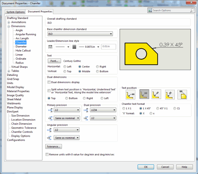

Setting |
Get/Set Methods |
Return Value or <Value> |
Comments |
Base chamfer dimension standard |
IModelDocExtension::GetUserPreferenceInteger(swUserPreferenceIntegerValue_e.swDetailingDimensionStandard,
swUserPreferenceOption_e.swDetailingChamferDimension)
IModelDocExtension::SetUserPreferenceInteger(swUserPreferenceIntegerValue_e.swDetailingDimensionStandard,
swUserPreferenceOption_e.swDetailingChamferDimension, swDetailingStandard_e.<Value>) |
See swDetailingStandard_e
for valid options |
Specifies the base chamfer dimensioning standard to use |

Tolerance... |
See Comments |
See Comments |
See Dimension Tolerance |
