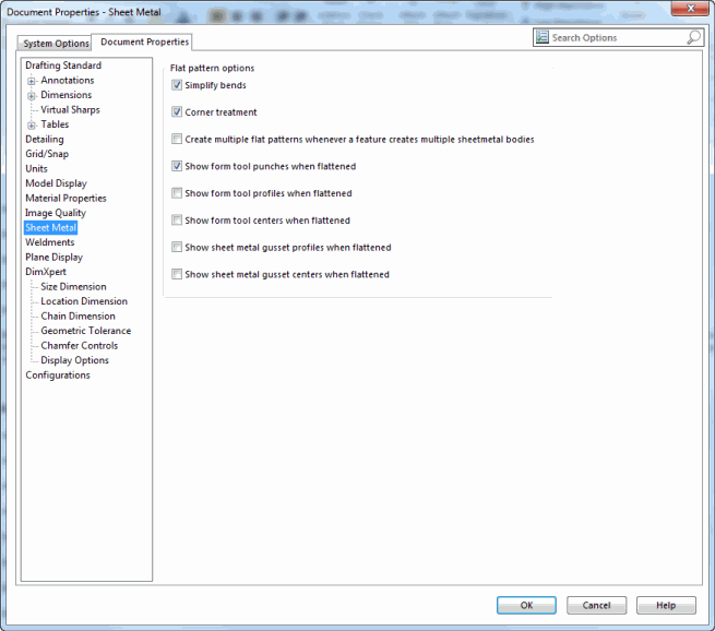

Setting |
Get/Set Methods |
Return Value or <Value> |
Comments |

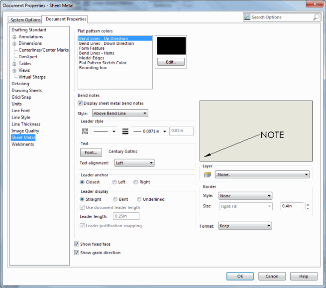

Flat pattern colors - Bend Lines - Up Direction |
IModelDocExtension::GetUserPreferenceInteger(swUserPreferenceIntegerValue_e.swSheetMetalColorBendLinesUp,
swUserPreferenceOption_e.swDetailingNoOptionSpecified)
IModelDocExtension::SetUserPreferenceInteger(swUserPreferenceIntegerValue_e.swSheetMetalColorBendLinesUp,
swUserPreferenceOption_e.swDetailingNoOptionSpecified, <Value>) |
Integer RGB value |
For drawings only |
Flat pattern colors - Bend Lines - Down Direction |
IModelDocExtension::GetUserPreferenceInteger(swUserPreferenceIntegerValue_e.swSheetMetalColorBendLinesDown,
IModelDocExtension::SetUserPreferenceInteger(swUserPreferenceIntegerValue_e.swSheetMetalColorBendLinesDown,
Integer RGB value |
For drawings only |
Flat pattern colors - Form Feature |
IModelDocExtension::GetUserPreferenceInteger(swUserPreferenceIntegerValue_e.swSheetMetalColorFormFeature,
IModelDocExtension::SetUserPreferenceInteger(swUserPreferenceIntegerValue_e.swSheetMetalColorFormFeature,
Integer RGB value |
For drawings only |
Flat pattern colors - Bend Lines - Hems |
IModelDocExtension::GetUserPreferenceInteger(swUserPreferenceIntegerValue_e.swSheetMetalColorBendLinesHems,
IModelDocExtension::SetUserPreferenceInteger(swUserPreferenceIntegerValue_e.swSheetMetalColorBendLinesHems,
Integer RGB value |
For drawings only |
Flat pattern colors - Model Edges |
IModelDocExtension::GetUserPreferenceInteger(swUserPreferenceIntegerValue_e.swSheetMetalColorModelEdges,
IModelDocExtension::SetUserPreferenceInteger(swUserPreferenceIntegerValue_e.swSheetMetalColorModelEdges,
Integer RGB value |
For drawings only |
Flat pattern colors - Flat Pattern Sketch Color |
IModelDocExtension::GetUserPreferenceInteger(swUserPreferenceIntegerValue_e.swSheetMetalColorFlatPatternSketch,
IModelDocExtension::SetUserPreferenceInteger(swUserPreferenceIntegerValue_e.swSheetMetalColorFlatPatternSketch,
Integer RGB value |
For drawings only |
Flat pattern colors - Bounding box |
IModelDocExtension::GetUserPreferenceInteger(swUserPreferenceIntegerValue_e.swSheetMetalColorBoundingBox,
IModelDocExtension::SetUserPreferenceInteger(swUserPreferenceIntegerValue_e.swSheetMetalColorBoundingBox,
Integer RGB value |
For drawings only |
Bend notes - Display sheet metal bend notes |
IModelDocExtension::GetUserPreferenceToggle(swUserPreferenceToggle_e.swShowSheetMetalBendNotes,
IModelDocExtension::SetUserPreferenceToggle(swUserPreferenceToggle_e.swShowSheetMetalBendNotes,
Boolean value |
For drawings only Specifies whether to show sheet metal bend notes |
Bend notes - Style |
IModelDocExtension::GetUserPreferenceInteger(swUserPreferenceIntegerValue_e.swBendNoteStyle,
IModelDocExtension::SetUserPreferenceInteger(swUserPreferenceIntegerValue_e.swBendNoteStyle,
swUserPreferenceOption_e.swDetailingNoOptionSpecified, swBendNoteStyle_e.<Value>) |
See swBendNoteStyle_e
for valid options |
For drawings only
Specifies where to place note with respect to bend lines |
Bend notes - Leader style - Line style |
IModelDocExtension::GetUserPreferenceInteger(swUserPreferenceIntegerValue_e.swSheetMetalBendNotesLeaderLineStyle,
IModelDocExtension::SetUserPreferenceInteger(swUserPreferenceIntegerValue_e.swSheetMetalBendNotesLeaderLineStyle,
swUserPreferenceOption_e.swDetailingNoOptionSpecified, swLineStyles_e.<Value>) |
See
swLineStyles_e
for valid options |
For drawings only |
Bend notes - Leader style - Line thickness |
IModelDocExtension::GetUserPreferenceInteger(swUserPreferenceIntegerValue_e.swSheetMetalBendNotesLeaderLineThickness,
IModelDocExtension::SetUserPreferenceInteger(swUserPreferenceIntegerValue_e.swSheetMetalBendNotesLeaderLineThickness,
swUserPreferenceOption_e.swDetailingNoOptionSpecified, swLineWeights_e.<Value>) |
See
swLineWeights_e
for valid options |
For drawings only If set to Custom Size, you must also
set Leader style - Line thickness - Custom Size |
Bend notes - Leader style - Line thickness - Custom Size |
IModelDocExtension::GetUserPreferenceDouble(swUserPreferenceDoubleValue_e.swSheetMetalBendNotesLeaderLineThicknessCustom,
IModelDocExtension::SetUserPreferenceDouble(swUserPreferenceDoubleValue_e.swSheetMetalBendNotesLeaderLineThicknessCustom,
Double value |
For drawings only Specifies a custom thickness for leader lines in sheet
metal drawings |
Bend notes - Text - Font... |
IModelDocExtension::GetUserPreferenceTextFormat(swUserPreferenceTextFormat_e.swSheetMetalBendNotesTextFormat,
IModelDocExtension::SetUserPreferenceTextFormat(swUserPreferenceTextFormat_e.swSheetMetalBendNotesTextFormat,
See ITextFormat
for font options |
For drawings only To set font property values, implement ITextFormat, set the appropriate
ITextFormat member values, and pass the ITextFormat object in this API's
set method |
Bend notes - Text - Text alignment |
IModelDocExtension::GetUserPreferenceInteger(swUserPreferenceIntegerValue_e.swSheetMetalBendNotesTextAlignment,
IModelDocExtension::SetUserPreferenceInteger(swUserPreferenceIntegerValue_e.swSheetMetalBendNotesTextAlignment,
swUserPreferenceOption_e.swDetailingNoOptionSpecified, swTextJustification_e.<Value>) |
See
for valid options; None is not a valid option |
For drawings only |
Bend notes - Leader anchor |
IModelDocExtension::GetUserPreferenceInteger(swUserPreferenceIntegerValue_e.swSheetMetalBendNotesLeaderAnchor,
IModelDocExtension::SetUserPreferenceInteger(swUserPreferenceIntegerValue_e.swSheetMetalBendNotesLeaderAnchor,
swUserPreferenceOption_e.swDetailingNoOptionSpecified, swLeaderSide_e.<Value>) |
See
swLeaderSide_e
for valid options |
For drawings only |
Bend notes - Leader display |
IModelDocExtension::GetUserPreferenceInteger(swUserPreferenceIntegerValue_e.swSheetMetalBendNotesLeaderDisplay,
IModelDocExtension::SetUserPreferenceInteger(swUserPreferenceIntegerValue_e.swSheetMetalBendNotesLeaderDisplay,
swUserPreferenceOption_e.swDetailingNoOptionSpecified, swLeaderStyle_e.<Value>) |
See
swLeaderStyle_e
for valid options |
For drawings only |
Bend notes - Leader display - Use document leader length |
IModelDocExtension::GetUserPreferenceToggle(swUserPreferenceToggle_e.swSheetMetalBendNotesUseDocLeaderLength,
IModelDocExtension::SetUserPreferenceToggle(swUserPreferenceToggle_e.swSheetMetalBendNotesUseDocLeaderLength,
Boolean value |
For drawings only |
Bend notes - Leader display - Leader length |
IModelDocExtension::GetUserPreferenceDouble(swUserPreferenceDoubleValue_e.swSheetMetalBendNotesLeaderLength,
IModelDocExtension::SetUserPreferenceDouble(swUserPreferenceDoubleValue_e.swSheetMetalBendNotesLeaderLength,
Double value |
For drawings only |
Bend notes - Leader display - Leader justification snapping |
IModelDocExtension::GetUserPreferenceToggle(swUserPreferenceToggle_e.swSheetMetalBendNotesLeaderJustificationSnapping,
IModelDocExtension::SetUserPreferenceToggle(swUserPreferenceToggle_e.swSheetMetalBendNotesLeaderJustificationSnapping,
Boolean value |
For drawings only |
Bend notes - Layer |
IModelDocExtension::GetUserPreferenceString(swUserPreferenceStringValue_e.swSheetMetalBendNotesLayer,
IModelDocExtension::SetUserPreferenceString(swUserPreferenceStringValue_e.swSheetMetalBendNotesLayer,
Valid Options:
- "Border"
- "Dimensions"
- "Notes"
- "BOM"
- "FORMAT"
For drawings only |
Bend notes - Border - Style |
IModelDocExtension::GetUserPreferenceInteger(swUserPreferenceIntegerValue_e.swSheetMetalBendNotesBorderStyle,
IModelDocExtension::SetUserPreferenceInteger(swUserPreferenceIntegerValue_e.swSheetMetalBendNotesBorderStyle,
swUserPreferenceOption_e.swDetailingNoOptionSpecified, swBalloonStyle_e.<Value>) |
See
swBalloonStyle_e
for valid options; swBS_SplitCir and swBS_Underline are not valid options |
For drawings only |
Bend notes - Border - Size |
IModelDocExtension::GetUserPreferenceInteger(swUserPreferenceIntegerValue_e.swSheetMetalBendNotesBorderSize,
IModelDocExtension::SetUserPreferenceInteger(swUserPreferenceIntegerValue_e.swSheetMetalBendNotesBorderSize,
swUserPreferenceOption_e.swDetailingNoOptionSpecified, swSheetMetalBendNotesBorderSize_e.<Value>) |
See
for valid options |
For drawings only If set to swSheetMetalBendNotesBorderSizeUserDefined,
you must also set Bend notes - Border - Size - Custom Size |
IModelDocExtension::GetUserPreferenceDouble(swUserPreferenceDoubleValue_e.swSheetMetalBendNotesBorderSizeCustom,
IModelDocExtension::SetUserPreferenceDouble(swUserPreferenceDoubleValue_e.swSheetMetalBendNotesBorderSizeCustom,
Double value |
For drawings only |
Show fixed face |
IModelDocExtension::GetUserPreferenceToggle(swUserPreferenceToggle_e.swFlatPatternOpt_ShowFixedFace,
IModelDocExtension::SetUserPreferenceToggle(swUserPreferenceToggle_e.swFlatPatternOpt_ShowFixedFace,
Boolean value |
For drawings only |
Show grain direction |
IModelDocExtension::SetUserPreferenceToggle(swUserPreferenceToggle_e.swFlatPatternOpt_ShowGrainDirection,
Boolean value |
For drawings only |
Flat pattern options - Simplify
bends |
IModelDocExtension::GetUserPreferenceToggle(swUserPreferenceToggle_e.swFlatPatternOpt_SimplifyBends,
IModelDocExtension::SetUserPreferenceToggle(swUserPreferenceToggle_e.swFlatPatternOpt_SimplifyBends,
Boolean value |
For parts and assemblies only |
Flat pattern options - Corner
treatment |
IModelDocExtension::GetUserPreferenceToggle(swUserPreferenceToggle_e.swFlatPatternOpt_CornerTreatment,
IModelDocExtension::SetUserPreferenceToggle(swUserPreferenceToggle_e.swFlatPatternOpt_CornerTreatment,
Boolean value |
Flat pattern options - Create
multiple flat patterns whenever a feature creates multiple sheet metal bodies |
IModelDocExtension::GetUserPreferenceToggle(swUserPreferenceToggle_e.swFlatPatternOpt_DisableSplitters,
IModelDocExtension::SetUserPreferenceToggle(swUserPreferenceToggle_e.swFlatPatternOpt_DisableSplitters,
Boolean value |
Flat pattern options - Show form
tool punches when flattened |
IModelDocExtension::GetUserPreferenceToggle(swUserPreferenceToggle_e.swFlatPatternOpt_ShowPunches,
IModelDocExtension::SetUserPrefenceToggle(swUserPreferenceToggle_e.swFlatPatternOpt_ShowPunches,
Boolean value |
For parts only |
tool profiles when flattened |
IModelDocExtension::GetUserPreferenceToggle(swUserPreferenceToggle_e.swFlatPatternOpt_ShowProfiles,
IModelDocExtension::SetUserPreferenceToggle(swUserPreferenceToggle_e.swFlatPatternOpt_ShowProfiles,
Boolean value |
For parts only |
tool centers when flattened |
IModelDocExtension::GetUserPreferenceToggle(swUserPreferenceToggle_e.swFlatPatternOpt_ShowCenters,
IModelDocExtension::SetUserPreferenceToggle(swUserPreferenceToggle_e.swFlatPatternOpt_ShowCenters,
Boolean value |
For parts only |
Flat pattern options - Show sheet metal gusset profiles when flattened |
IModelDocExtension::GetUserPreferenceToggle(swUserPreferenceToggle_e.swFlatPatternOpt_WhenFlattenedShowGussetProfiles,
IModelDocExtension::SetUserPreferenceToggle(swUserPreferenceToggle_e.swFlatPatternOpt_WhenFlattenedShowGussetProfiles,
Boolean value |
For parts only |
Flat pattern options - Show sheet metal gusset centers when flattened |
IModelDocExtension::GetUserPreferenceToggle(swUserPreferenceToggle_e.swFlatPatternOpt_WhenFlattenedShowGussetCenters,
IModelDocExtension::SetUserPreferenceToggle(swUserPreferenceToggle_e.swFlatPatternOpt_WhenFlattenedShowGussetCenters,
Boolean value |
For parts only |
