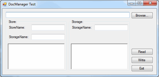

//  8. Substitute your_license_key with your SOLIDWORKS Document
//     Manager license key.
// Postconditions:
//  1. Displays a dialog.
//  2. Click Browse.
//     a. Locate and click a SOLIDWORKS document.
//     b. Click Open.
//  3. Type temp in StoreName and in both StorageName fields.
//  4. Type Some third-party text in both text boxes.
//  5. Click Write.
//  6. Click Exit.
//  7. Press F5.
//  8. In the dialog, click Browse.
//     a. Locate and click the document you clicked in step 2a.
//     b. Click Open.
//  9. Type temp in StoreName and in both StorageName fields.
// 10. Click Read.
// 11. Displays Some third-party text in both text boxes.
// 12. Click Exit.

            this.label1 = new System.Windows.Forms.Label();
            this.label3 = new System.Windows.Forms.Label();
            this.txtStreamName = new System.Windows.Forms.TextBox();
            this.groupBox2 = new System.Windows.Forms.GroupBox();
            this.label5 = new System.Windows.Forms.Label();
            this.txtStorageName = new System.Windows.Forms.TextBox();
            this.groupBox1.SuspendLayout();
            this.groupBox2.SuspendLayout();
            this.SuspendLayout();
            // rtbStorage
            this.rtbStorage.Location = new System.Drawing.Point(6, 83);
            this.rtbStorage.Name = "rtbStorage";
            this.rtbStorage.Size = new System.Drawing.Size(198, 91);
            this.rtbStorage.TabIndex = 15;
            this.rtbStorage.Text = "";
            // rtbStore
            this.rtbStore.Location = new System.Drawing.Point(6, 83);
            this.rtbStore.Name = "rtbStore";
            this.rtbStore.Size = new System.Drawing.Size(198, 91);
            this.rtbStore.TabIndex = 14;
            this.rtbStore.Text = "";
            // btnExit
            this.btnExit.Location = new System.Drawing.Point(448, 197);
            this.btnExit.Name = "btnExit";
            this.btnExit.Size = new System.Drawing.Size(75, 23);
            this.btnExit.TabIndex = 13;
            this.btnExit.Text = "Exit";
            this.btnExit.UseVisualStyleBackColor = true;
            this.btnExit.Click += new System.EventHandler(this.btnExit_Click);
            // btnSave
            this.btnSave.Location = new System.Drawing.Point(448, 168);
            this.btnSave.Name = "btnSave";
            this.btnSave.Size = new System.Drawing.Size(75, 23);
            this.btnSave.TabIndex = 12;
            this.btnSave.Text = "Write";
            this.btnSave.UseVisualStyleBackColor = true;
            this.btnSave.Click += new System.EventHandler(this.btnSave_Click);
            // btnOpen
            this.btnOpen.Location = new System.Drawing.Point(448, 139);
            this.btnOpen.Name = "btnOpen";
            this.btnOpen.Size = new System.Drawing.Size(75, 23);
            this.btnOpen.TabIndex = 11;
            this.btnOpen.Text = "Read";
            this.btnOpen.UseVisualStyleBackColor = true;
            this.btnOpen.Click += new System.EventHandler(this.btnOpen_Click);
            // btnFile
            this.btnFile.Location = new System.Drawing.Point(448, 12);
            this.btnFile.Name = "btnFile";
            this.btnFile.Size = new System.Drawing.Size(75, 23);
            this.btnFile.TabIndex = 10;
            this.btnFile.Text = "Browse...";
            this.btnFile.UseVisualStyleBackColor = true;
            this.btnFile.Click += new System.EventHandler(this.btnFile_Click);
            // OpenFileDialog1
            this.OpenFileDialog1.FileName = "OpenFileDialog1";
            // txtFileName
            this.txtFileName.Location = new System.Drawing.Point(12, 12);
            this.txtFileName.Name = "txtFileName";
            this.txtFileName.Size = new System.Drawing.Size(430, 20);
            this.txtFileName.TabIndex = 9;
            // groupBox1
            this.groupBox1.Controls.Add(this.label3);
            this.groupBox1.Controls.Add(this.txtStreamName);
            this.groupBox1.Controls.Add(this.label1);
            this.groupBox1.Controls.Add(this.txtStoreName);
            this.groupBox1.Controls.Add(this.rtbStore);
            this.groupBox1.Location = new System.Drawing.Point(13, 39);
            this.groupBox1.Name = "groupBox1";
            this.groupBox1.Size = new System.Drawing.Size(210, 180);
            this.groupBox1.TabIndex = 18;
            this.groupBox1.TabStop = false;
            this.groupBox1.Text = "Store:";
            // txtStoreName
            this.txtStoreName.Location = new System.Drawing.Point(88, 17);
            this.txtStoreName.Name = "txtStoreName";
            this.txtStoreName.Size = new System.Drawing.Size(116, 20);
            this.txtStoreName.TabIndex = 15;
            // label1
            this.label1.AutoSize = true;
            this.label1.Location = new System.Drawing.Point(7, 20);
            this.label1.Name = "label1";
            this.label1.Size = new System.Drawing.Size(63, 13);
            this.label1.TabIndex = 16;
            this.label1.Text = "StoreName:";
            // label3
            this.label3.AutoSize = true;
            this.label3.Location = new System.Drawing.Point(7, 53);
            this.label3.Name = "label3";
            this.label3.Size = new System.Drawing.Size(75, 13);
            this.label3.TabIndex = 18;
            this.label3.Text = "StorageName:";
            // txtStreamName
            this.txtStreamName.Location = new System.Drawing.Point(88, 50);
            this.txtStreamName.Name = "txtStreamName";
            this.txtStreamName.Size = new System.Drawing.Size(116, 20);
            this.txtStreamName.TabIndex = 17;
            // groupBox2
            this.groupBox2.Controls.Add(this.rtbStorage);
            this.groupBox2.Controls.Add(this.label5);
            this.groupBox2.Controls.Add(this.txtStorageName);
            this.groupBox2.Location = new System.Drawing.Point(232, 39);
            this.groupBox2.Name = "groupBox2";
            this.groupBox2.Size = new System.Drawing.Size(210, 180);
            this.groupBox2.TabIndex = 19;
            this.groupBox2.TabStop = false;
            this.groupBox2.Text = "Storage:";
            // label5
            this.label5.AutoSize = true;
            this.label5.Location = new System.Drawing.Point(7, 20);
            this.label5.Name = "label5";
            this.label5.Size = new System.Drawing.Size(75, 13);
            this.label5.TabIndex = 16;
            this.label5.Text = "StorageName:";
            // txtStorageName
            this.txtStorageName.Location = new System.Drawing.Point(88, 17);
            this.txtStorageName.Name = "txtStorageName";
            this.txtStorageName.Size = new System.Drawing.Size(116, 20);
            this.txtStorageName.TabIndex = 15;
            // Form1
            this.AutoScaleDimensions = new System.Drawing.SizeF(6F, 13F);
            this.AutoScaleMode = System.Windows.Forms.AutoScaleMode.Font;
            this.ClientSize = new System.Drawing.Size(536, 231);
            this.Controls.Add(this.btnExit);
            this.Controls.Add(this.btnSave);
            this.Controls.Add(this.btnOpen);
            this.Controls.Add(this.btnFile);
            this.Controls.Add(this.txtFileName);
            this.Controls.Add(this.groupBox1);
            this.Controls.Add(this.groupBox2);
            this.MaximumSize = new System.Drawing.Size(552, 269);
            this.MinimumSize = new System.Drawing.Size(552, 269);
            this.Name = "Form1";
            this.Text = "DocManager Test";
            this.groupBox1.ResumeLayout(false);
            this.groupBox1.PerformLayout();
            this.groupBox2.ResumeLayout(false);
            this.groupBox2.PerformLayout();
            this.ResumeLayout(false);
            this.PerformLayout();
        #endregion
        internal System.Windows.Forms.RichTextBox rtbStorage;
        internal System.Windows.Forms.RichTextBox rtbStore;
        internal System.Windows.Forms.Button btnExit;
        internal System.Windows.Forms.Button btnSave;
        internal System.Windows.Forms.Button btnOpen;
        internal System.Windows.Forms.Button btnFile;
        internal System.Windows.Forms.OpenFileDialog OpenFileDialog1;
        internal System.Windows.Forms.TextBox txtFileName;
        private System.Windows.Forms.GroupBox groupBox1;
        private System.Windows.Forms.Label label3;
        private System.Windows.Forms.TextBox txtStreamName;
        private System.Windows.Forms.Label label1;
        private System.Windows.Forms.TextBox txtStoreName;
        private System.Windows.Forms.GroupBox groupBox2;
        private System.Windows.Forms.Label label5;
        private System.Windows.Forms.TextBox txtStorageName;
