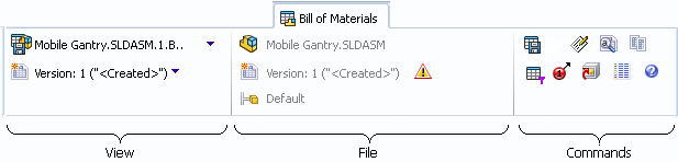

Use the Bill of Materials tab to view named BOMs. Named BOMs can be saved from computed BOMs and SOLIDWORKS BOMs.
To display a computed BOM:
In your local file vault, select a SOLIDWORKS assembly or drawing. On the Bill of Materials tab, for BOM, select a named BOM
icon or SOLIDWORKS named BOM
icon.
File
Information about the file associated with the named BOM.
| Source |
(Read-only) The assembly or drawing that is associated with the named BOM. |
| Source version |
(Read-only) The version of the associated file. The Update Source Version icon at the end of the text field appears as
if a more recent version of the source file exists and you can update the named BOM data to match it.
If the icon appears as , the named BOM is based on the latest version of the source file.
| Configuration |
(Read-only) The configuration of the associated file. |
