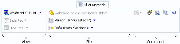

The Bill of Materials toolbar layout for both weldment BOMs and weldment cut lists is the same:
BOM_UI_Weldment_cutlist
View
Bill of Materials The selected BOM type, either Weldment Cut List or Weldment BOM .
File
Source (Read-only) The weldment part file name.
File Version The version of the file.
Configuration A configuration name.
Commands
These commands are available for both weldment cut lists and weldment BOMs.
BOM_UI_Open_as_CSV_file Open As CSV Open the BOM in Excel as a comma-delimited file.
Search Search the BOM for a text string.
Compare Changes the Bill of Materials tab layout so that you can select a second BOM to compare.
Help Access context-sensitive help.
