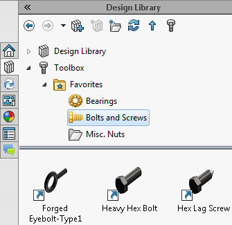

  1. In the Task Pane, on the Design Library tab, expand Toolbox.
  2. Select the Favorites folder and click Create New Folder .
  3. Type a name for the subfolder.
    If you use standard Toolbox folder names such as Bearings or Bolts and Screws, the software displays the names with the appropriate icons. Otherwise a generic folder icon represents the folder.
    The new folder appears under the Favorites folder and is created on your local computer in C:\Users\username\AppData\Roaming\SOLIDWORKS\SOLIDWORKSrelease\Toolbox\Favorites.
  4. Using the Toolbox library of components, expand the standard, category, and type of component to save as a favorite.
  5. Select the component and drag it to the subfolder.
    Each favorite you save appears as a shortcut in the Favorites subfolder and in the Favorites directory on your local computer.
    If a Toolbox component is moved, deleted, or disabled, a warning flag appears on the shortcut.
    Hover over the favorite to display a tooltip that describes the problem.
  6. To use a favorite, select it in the Favorites subfolder and drag it to the graphics area, just as you would a component in one of the other Toolbox folders.
