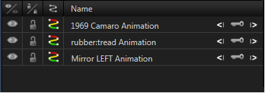

Animation List
A list of existing animations is displayed under the basic animation controls.
Show/Hide Animation Shows or hides the animation on the timeline. Hidden animations do not play back in realtime and do not render.
Lock Animation Controls whether you can edit the animation.
Editing is allowed when the animation is unlocked and prevented when it is locked .
Show/Hide Animation Ribbon in Viewport Shows or hides the Animation ribbon for the selected animation. For camera animations, the Animation ribbon is visible only if you view the scene through a different camera than the one you are animating.
  Name Displays animation name. Click the name to change it.
Move to Previous Keyframe Moves the current time forward one keyframe.
Create Keyframe at Current Time Adds a keyframe at the current time.
Move to Next Keyframe Moves the current time backward one keyframe.
