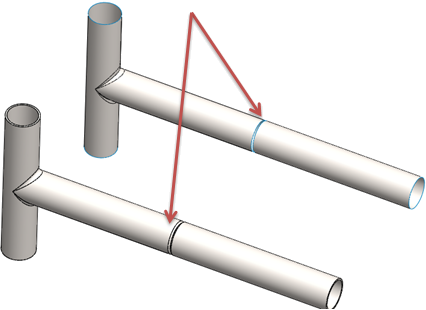

Mid-surface shells from sheet metal plates with a gap due to welding. Bonded contact is detected for the pair of parallel shell edges within the specified distance.
Bonded contact is detected for the pair of circular concentric shell edges within the specified distance.

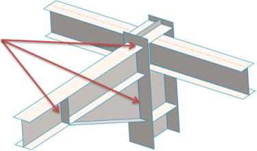

Bonded contact is detected between the shell edges (from gussets and beams) and the shell faces of beams.
