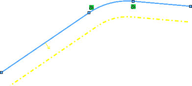

You can create offset geometry as construction geometry while using the Offset Entities tool.
Previously, you could only convert the base geometry to construction geometry.
To access Base geometry and Offset geometry construction geometry options, select a sketch entity and click Tools > Sketch Tools > Offset Entities .
Construction Geometry option for Offset geometry
Construction Geometry for Base geometry and Offset geometry
