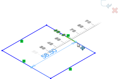

- View the dimension handles or Instant2D Rulers
while selecting dimensions in sketch mode.

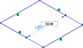

![](uuf1450373145302.image) |
Instant2D Rulers |
![](lym1450373145911.image) |
Dimension input value box |
