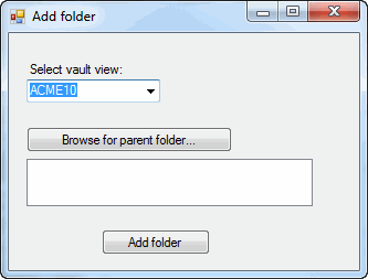

// Postconditions:
// 1. Displays the Add folder dialog box.
//    a. Select a vault view.
