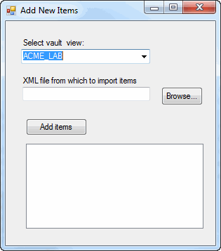

This example shows how to add items to a vault. The data for the items is imported from an XML file, which is read by the .NET XmlReader.
NOTE: If using the .NET Framework 4.0 primary interop assembly provided with SOLIDWORKS PDM Professional, see Using .NET Framework 4.0 in Stand-alone Applications.

'     f. Create a form similar to the form shown above and change:
'        1. Top label to VaultsLabel.
'        2. Combo box to VaultsComboBox.
'        3. Second label to XmlLabel.
'        4. Text box to XmlTextBox.
'        5. Browse button to BrowseButton.
'        6. Add items button to AddItemsButton.
'        7. List box to ItemsListBox.

'  1. Displays a dialog.
'  2. Select a vault.
'  3. Click the Browse button, locate and click Items.xml, and click Open.
'  4. Click the Add items button.
'     The new items are printed in the dialog's list.
'  5. Close the dialog.

   <System.Diagnostics.DebuggerStepThrough()> _
   Private Sub InitializeComponent()
        Me.BrowseButton = New System.Windows.Forms.Button()
        Me.XmlTextBox = New System.Windows.Forms.TextBox()
        Me.XmlLabel = New System.Windows.Forms.Label()
        Me.XmlOpenFileDialog = New System.Windows.Forms.OpenFileDialog()
        Me.AddItemsButton = New System.Windows.Forms.Button()
        Me.VaultsComboBox = New System.Windows.Forms.ComboBox()
        Me.VaultsLabel = New System.Windows.Forms.Label()
        Me.ItemsListBox = New System.Windows.Forms.ListBox()
        Me.SuspendLayout()
        'BrowseButton
        Me.BrowseButton.Location = New System.Drawing.Point(222, 94)
        Me.BrowseButton.Margin = New System.Windows.Forms.Padding(2)
        Me.BrowseButton.Name = "BrowseButton"
        Me.BrowseButton.Size = New System.Drawing.Size(59, 26)
        Me.BrowseButton.TabIndex = 0
        Me.BrowseButton.Text = "Browse..."
        Me.BrowseButton.UseVisualStyleBackColor = True
        'XmlTextBox
        Me.XmlTextBox.Location = New System.Drawing.Point(24, 94)
        Me.XmlTextBox.Margin = New System.Windows.Forms.Padding(2)
        Me.XmlTextBox.Name = "XmlTextBox"
        Me.XmlTextBox.Size = New System.Drawing.Size(182, 20)
        Me.XmlTextBox.TabIndex = 1
        'XmlLabel
        Me.XmlLabel.AutoSize = True
        Me.XmlLabel.Location = New System.Drawing.Point(22, 78)
        Me.XmlLabel.Margin = New System.Windows.Forms.Padding(2, 0, 2, 0)
        Me.XmlLabel.Name = "XmlLabel"
        Me.XmlLabel.Size = New System.Drawing.Size(172, 13)
        Me.XmlLabel.TabIndex = 2
        Me.XmlLabel.Text = "XML file from which to import items:"
        'XmlOpenFileDialog
        Me.XmlOpenFileDialog.Filter = "XML files|*.xml"
        'AddItemsButton
        Me.AddItemsButton.Location = New System.Drawing.Point(29, 139)
        Me.AddItemsButton.Margin = New System.Windows.Forms.Padding(2)
        Me.AddItemsButton.Name = "AddItemsButton"
        Me.AddItemsButton.Size = New System.Drawing.Size(87, 24)
        Me.AddItemsButton.TabIndex = 3
        Me.AddItemsButton.Text = "Add items"
        Me.AddItemsButton.UseVisualStyleBackColor = True
        'VaultsComboBox
        Me.VaultsComboBox.FormattingEnabled = True
        Me.VaultsComboBox.Location = New System.Drawing.Point(22, 40)
        Me.VaultsComboBox.Margin = New System.Windows.Forms.Padding(2)
        Me.VaultsComboBox.Name = "VaultsComboBox"
        Me.VaultsComboBox.Size = New System.Drawing.Size(184, 21)
        Me.VaultsComboBox.TabIndex = 12
        'VaultsLabel
        Me.VaultsLabel.AutoSize = True
        Me.VaultsLabel.Location = New System.Drawing.Point(22, 24)
        Me.VaultsLabel.Margin = New System.Windows.Forms.Padding(2, 0, 2, 0)
        Me.VaultsLabel.Name = "VaultsLabel"
        Me.VaultsLabel.Size = New System.Drawing.Size(94, 13)
        Me.VaultsLabel.TabIndex = 13
        Me.VaultsLabel.Text = "Select vault  view:"
        'ItemsListBox
        Me.ItemsListBox.FormattingEnabled = True
        Me.ItemsListBox.Location = New System.Drawing.Point(29, 175)
        Me.ItemsListBox.Margin = New System.Windows.Forms.Padding(2)
        Me.ItemsListBox.Name = "ItemsListBox"
        Me.ItemsListBox.Size = New System.Drawing.Size(253, 121)
        Me.ItemsListBox.TabIndex = 14
        'AddItems
        Me.AutoScaleDimensions = New System.Drawing.SizeF(6.0!, 13.0!)
        Me.AutoScaleMode = System.Windows.Forms.AutoScaleMode.Font
        Me.ClientSize = New System.Drawing.Size(299, 320)
        Me.Controls.Add(Me.ItemsListBox)
        Me.Controls.Add(Me.VaultsComboBox)
        Me.Controls.Add(Me.VaultsLabel)
        Me.Controls.Add(Me.AddItemsButton)
        Me.Controls.Add(Me.XmlLabel)
        Me.Controls.Add(Me.XmlTextBox)
        Me.Controls.Add(Me.BrowseButton)
        Me.Margin = New System.Windows.Forms.Padding(2)
        Me.Name = "AddItems"
        Me.Text = "Add New Items"
        Me.ResumeLayout(False)
        Me.PerformLayout()
    End Sub
   Friend WithEvents BrowseButton As System.Windows.Forms.Button
   Friend WithEvents XmlTextBox As System.Windows.Forms.TextBox
   Friend WithEvents XmlLabel As System.Windows.Forms.Label
   Friend WithEvents XmlOpenFileDialog As System.Windows.Forms.OpenFileDialog
   Friend WithEvents AddItemsButton As System.Windows.Forms.Button
   Friend WithEvents VaultsComboBox As System.Windows.Forms.ComboBox
   Friend WithEvents VaultsLabel As System.Windows.Forms.Label
   Friend WithEvents ItemsListBox As System.Windows.Forms.ListBox
End Class
