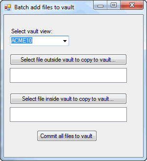

This example shows how to add several files and folders to the vault in one batch.

// Postconditions:
//  1. The Batch add files to vault dialog box displays.
//     a. Select a vault view.
//     b. Click Select file outside vault to copy to vault.
//     c. In the Select File dialog:
//        1. Click a file outside the vault.
//        2. Click Open.
//     d. Click Select file inside vault to copy to vault.
//     e. In the Select File dialog:
//        1. Click a file in the vault.
//        2. Click Open.
//     f. Click Commit all files to vault.
//  2. Click Add in the Batch Items dialog box.
//  3. Click OK to close the message box.
//     Two new folders, Folder1 and Folder2, are created in the vault's
//     root directory. The first selected file is copied to Folder1.
//     The second selected file is copied to Folder2.
//  4. Close the Batch add files to vault dialog box.

            this.CopyFromVault.Name = "CopyFromVault";
            this.CopyFromVault.Size = new System.Drawing.Size(239, 23);
            this.CopyFromVault.TabIndex = 5;
            this.CopyFromVault.Text = "Select file inside vault to copy to vault...";
            this.CopyFromVault.UseVisualStyleBackColor = true;
            this.CopyFromVault.Click += new System.EventHandler(this.CopyFromVault_Click);
            //FileList2
            this.FileList2.FormattingEnabled = true;
            this.FileList2.Location = new System.Drawing.Point(12, 189);
            this.FileList2.Name = "FileList2";
            this.FileList2.Size = new System.Drawing.Size(239, 30);
            this.FileList2.TabIndex = 6;
            //SelectFileDialog
            this.SelectFileDialog.Title = "Select File";
            //Form1
            this.AutoScaleDimensions = new System.Drawing.SizeF(6f, 13f);
            this.AutoScaleMode = System.Windows.Forms.AutoScaleMode.Font;
            this.ClientSize = new System.Drawing.Size(284, 291);
            this.Controls.Add(this.FileList2);
            this.Controls.Add(this.CopyFromVault);
            this.Controls.Add(this.FileList1);
            this.Controls.Add(this.CopyToVault);
            this.Controls.Add(this.BatchAdd);
            this.Controls.Add(this.VaultsComboBox);
            this.Controls.Add(this.VaultsLabel);
            this.Name = "Form1";
            this.Text = "Batch add files to vault";
            this.Load += new System.EventHandler(this.Form1_Load);
            this.ResumeLayout(false);
            this.PerformLayout();
        #endregion
