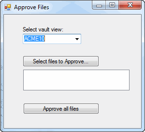

' Postconditions:
' 1. The Approve Files dialog box displays.
'    a. Select a vault view.
'    b. Click Select files to approve.
'    c. In the Select File dialog:
'       1. Select vault files in the Waiting for Approval state.
'       2. Click Open.
'    d. Click Approve all files.
' 2. Click OK in the Do Transition dialog box.
'    The selected files change to the Approved state using the Passed Approval
'    transition.
' 3. Close the Approve Files dialog box.

        Me.BatchChange.Text = "Approve all files"

        Me.Text = "Approve Files"
