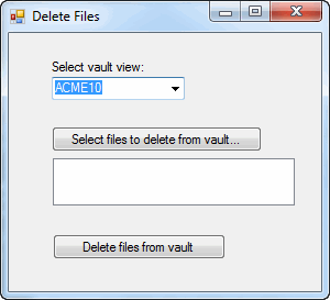

'  1. The Delete Files dialog box displays.
'     a. Select a vault view.
'     b. Click Select files to delete from vault.
'     c. In the Select File dialog:
'        1. Click a file inside the vault.
'        2. Click Open.
'     d. Click Delete files from vault.
'  2. Click Delete in the Confirm Multiple File Delete dialog box.
'     a. If no errors occur, the selected file and Folder1 are moved
'        from the vault to the SOLIDWORKS PDM recycling bin. (To see the
'        SOLIDWORKS PDM recycling bin, right-click your vault, click
'        Properties, and click Deleted Items.)
'     b. If an error dialog box pops up, click OK to close it.
'  3. Close the Delete Files dialog box.

        Me.VaultsLabel = New System.Windows.Forms.Label()
        Me.VaultsComboBox = New System.Windows.Forms.ComboBox()
        Me.SelectFiles = New System.Windows.Forms.Button()
        Me.File1List = New System.Windows.Forms.ListBox()
        Me.BatchDelete = New System.Windows.Forms.Button()
        Me.OpenFileDialog1 = New System.Windows.Forms.OpenFileDialog()
        Me.SuspendLayout()
        'VaultsLabel
        Me.VaultsLabel.AutoSize = True
        Me.VaultsLabel.Location = New System.Drawing.Point(36, 24)
        Me.VaultsLabel.Name = "VaultsLabel"
        Me.VaultsLabel.Size = New System.Drawing.Size(91, 13)
        Me.VaultsLabel.TabIndex = 0
        Me.VaultsLabel.Text = "Select vault view:"
        'VaultsComboBox
        Me.VaultsComboBox.FormattingEnabled = True
        Me.VaultsComboBox.Location = New System.Drawing.Point(39, 40)
        Me.VaultsComboBox.Name = "VaultsComboBox"
        Me.VaultsComboBox.Size = New System.Drawing.Size(121, 21)
        Me.VaultsComboBox.TabIndex = 1
        'SelectFiles
        Me.SelectFiles.Location = New System.Drawing.Point(39, 85)
        Me.SelectFiles.Name = "SelectFiles"
        Me.SelectFiles.Size = New System.Drawing.Size(191, 23)
        Me.SelectFiles.TabIndex = 2
        Me.SelectFiles.Text = "Select files to delete from vault..."
        Me.SelectFiles.UseVisualStyleBackColor = True
        'File1List
        Me.File1List.FormattingEnabled = True
        Me.File1List.HorizontalScrollbar = True
        Me.File1List.Location = New System.Drawing.Point(40, 114)
        Me.File1List.Name = "File1List"
        Me.File1List.SelectionMode = System.Windows.Forms.SelectionMode.MultiExtended
        Me.File1List.Size = New System.Drawing.Size(220, 43)
        Me.File1List.TabIndex = 4
        'BatchDelete
        Me.BatchDelete.Location = New System.Drawing.Point(40, 183)
        Me.BatchDelete.Name = "BatchDelete"
        Me.BatchDelete.Size = New System.Drawing.Size(157, 23)
        Me.BatchDelete.TabIndex = 6
        Me.BatchDelete.Text = "Delete files from vault"
        Me.BatchDelete.UseVisualStyleBackColor = True
        'OpenFileDialog1
        Me.OpenFileDialog1.FileName = "OpenFileDialog1"
Me.OpenFileDialog1.Multiselect = True
        Me.OpenFileDialog1.Title = "Select File"
        'Form1
        Me.AutoScaleDimensions = New System.Drawing.SizeF(6.0!, 13.0!)
        Me.AutoScaleMode = System.Windows.Forms.AutoScaleMode.Font
        Me.ClientSize = New System.Drawing.Size(284, 235)
        Me.Controls.Add(Me.BatchDelete)
        Me.Controls.Add(Me.File1List)
        Me.Controls.Add(Me.SelectFiles)
        Me.Controls.Add(Me.VaultsComboBox)
        Me.Controls.Add(Me.VaultsLabel)
        Me.Name = "Form1"
        Me.Text = "Delete Files"
        Me.ResumeLayout(False)
        Me.PerformLayout()
    End Sub
    Friend WithEvents VaultsLabel As System.Windows.Forms.Label
    Friend WithEvents VaultsComboBox As System.Windows.Forms.ComboBox
    Friend WithEvents SelectFiles As System.Windows.Forms.Button
    Friend WithEvents File1List As System.Windows.Forms.ListBox
    Friend WithEvents BatchDelete As System.Windows.Forms.Button
    Friend WithEvents OpenFileDialog1 As System.Windows.Forms.OpenFileDialog
End Class
