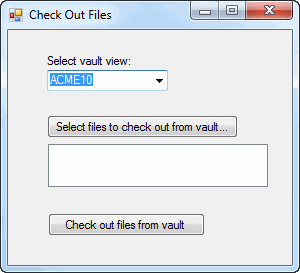

// 1. The Check Out Files dialog box displays.
// a. Select a vault view.
// b. Click Select files to check out from vault.
// c. In the Select File dialog:
// 1. Click a
couple of files inside the vault.
// 2. Click Open.
// d. Click Check out files from vault.
// 2. Click Check Out in the Check Out dialog box.
// 3. Close the Check Out Files dialog box.
// 4. Observe that the selected files are checked out of the selected vault.

private void InitializeComponent()
this.VaultsLabel = new System.Windows.Forms.Label();
this.VaultsComboBox = new System.Windows.Forms.ComboBox();
this.SelectFiles = new System.Windows.Forms.Button();
this.File1List = new System.Windows.Forms.ListBox();
this.BatchGet = new System.Windows.Forms.Button();
this.OpenFileDialog1 = new System.Windows.Forms.OpenFileDialog();
this.SuspendLayout();
//VaultsLabel
this.VaultsLabel.AutoSize = true;
this.VaultsLabel.Location = new System.Drawing.Point(36, 24);
this.VaultsLabel.Name = "VaultsLabel";
this.VaultsLabel.Size = new System.Drawing.Size(91, 13);
this.VaultsLabel.TabIndex = 0;
this.VaultsLabel.Text = "Select vault view:";
//VaultsComboBox
this.VaultsComboBox.FormattingEnabled = true;
this.VaultsComboBox.Location = new System.Drawing.Point(39, 40);
this.VaultsComboBox.Name = "VaultsComboBox";
this.VaultsComboBox.Size = new System.Drawing.Size(121, 21);
this.VaultsComboBox.TabIndex = 1;
//SelectFiles
this.SelectFiles.Location = new System.Drawing.Point(39, 85);
this.SelectFiles.Name = "SelectFiles";
this.SelectFiles.Size = new System.Drawing.Size(191, 23);
this.SelectFiles.TabIndex = 2;
this.SelectFiles.Text = "Select files to check out from vault...";
this.SelectFiles.UseVisualStyleBackColor = true;
this.SelectFiles.Click += new System.EventHandler(SelectFiles_Click);
//File1List
this.File1List.FormattingEnabled = true;
this.File1List.HorizontalScrollbar = true;
this.File1List.Location = new System.Drawing.Point(40, 114);
this.File1List.Name = "File1List";
this.File1List.SelectionMode = System.Windows.Forms.SelectionMode.MultiExtended;
this.File1List.Size = new System.Drawing.Size(220, 43);
this.File1List.TabIndex = 4;
//BatchGet
this.BatchGet.Location = new System.Drawing.Point(40, 183);
this.BatchGet.Name = "BatchGet";
this.BatchGet.Size = new System.Drawing.Size(157, 23);
this.BatchGet.TabIndex = 6;
this.BatchGet.Text = "Check out files from vault";
this.BatchGet.UseVisualStyleBackColor = true;
this.BatchGet.Click += new System.EventHandler(this.BatchGet_Click);
//OpenFileDialog1
this.OpenFileDialog1.FileName = "OpenFileDialog1";
this.OpenFileDialog1.Multiselect = true;
this.OpenFileDialog1.Title = "Select File";
//Form1
this.AutoScaleDimensions = new System.Drawing.SizeF(6f, 13f);
this.AutoScaleMode = System.Windows.Forms.AutoScaleMode.Font;
this.ClientSize = new System.Drawing.Size(284, 235);
this.Controls.Add(this.BatchGet);
this.Controls.Add(this.File1List);
this.Controls.Add(this.SelectFiles);
this.Controls.Add(this.VaultsComboBox);
this.Controls.Add(this.VaultsLabel);
this.Name = "Form1";
this.Text = "Check Out Files";
this.Load += new System.EventHandler(this.Form1_Load);
this.ResumeLayout(false);
this.PerformLayout();
internal System.Windows.Forms.Label VaultsLabel;
internal System.Windows.Forms.ComboBox VaultsComboBox;
internal System.Windows.Forms.Button SelectFiles;
internal System.Windows.Forms.ListBox File1List;
internal System.Windows.Forms.Button BatchGet;
internal System.Windows.Forms.OpenFileDialog OpenFileDialog1;
