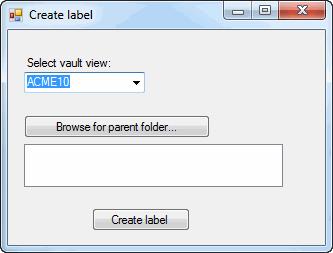

// Postconditions:
// 1. Displays the Create label dialog box.
//    a. Select a vault view.
//    b. Click Browse for parent folder
//       1. Locate and click a folder in the vault.
//       2. Click OK.
//    c. Click Create label.
//       1. Creates label, MyCompany, on the selected folder and all of its
//          subfolders and files.
//       2. Displays a message box with information about all of the labels
//          on the selected folder.
//       3. Click OK.
// 2. Close the Create label dialog box.
