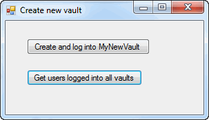

// Postconditions:
// 1. Displays the Create new vault dialog box.
//    a. Click Create and log in to MyNewVault.
//    b. After a few seconds, displays a login dialog.
//    c. Type Admin's password in Password.
//    d. Click Log in.
//       1. MyNewVault is created using the Default configuration in the root
//          folder of the archive server.
//       2. A view of MyNewVault, accessible to all users, is created in c:\temp.
//       3. Admin is logged into MyNewVault.
//    e. Click Get users logged into all vaults
//    f. Displays a dialog with all of the users currently logged into
//       vault views on this machine.
//    g. Click OK.
// 2. Close the Create new vault dialog box.

            this.Text = "Create new vault";
