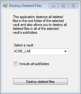

This example shows how to create an application that displays a form in which a user can select the vault in whose root folder and subfolders all deleted files will be permanently destroyed. The user must have permission to delete files.

//  6. Create a form similar to the form shown above and change:
//     a. Second label to VaultsLabel.
//     b. Combo box to VaultsComboBox.
//     c. Check box to CheckBox_Recursive.
//     d. Button to DestroyDeletedItemsButton.
//  7. Replace the code in Form1.cs with this code.
//  8. Replace the code in Form1.Designer.cs with this code.

// Postconditions:
//  1. Displays the Destroy Deleted Files dialog.
//  2. Select a vault.
//  3. Optionally select the Include all subfolders check box.
//  4. Click the Destroy deleted files button.
//     A message box pops up informing you that:
//     * No deleted files were found to destroy.
//       - or -
//     * The deleted files were destroyed.
//  5. Click OK in the message box.
//  6. Close the Destroy Deleted Files dialog.
