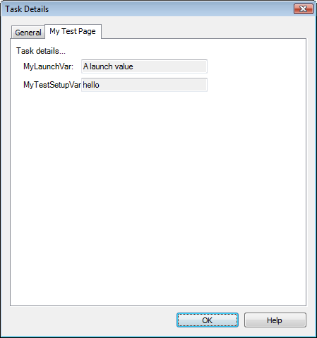

Private Sub OnTaskDetails(ByRef poCmd As EdmCmd, ByRef ppoData As System.Array)
  Dim inst As IEdmTaskInstance
  inst = poCmd.mpoExtra
  'Create a custom page in the task properties dialog box; TaskDetailsPage is a
  'user control; TaskDetailsPage::LoadData fills in some edit boxes with
  'values from IEdmTaskInstance::GetValEx
  Dim myPage As TaskDetailsPage
  myPage = New TaskDetailsPage
  myPage.CreateControl()
  poCmd.mpoExtra = myPage
  poCmd.mlParentWnd = myPage.Handle.ToInt32
  poCmd.mbsComment = "My Test Page"
  myPage.LoadData(inst)
End Sub

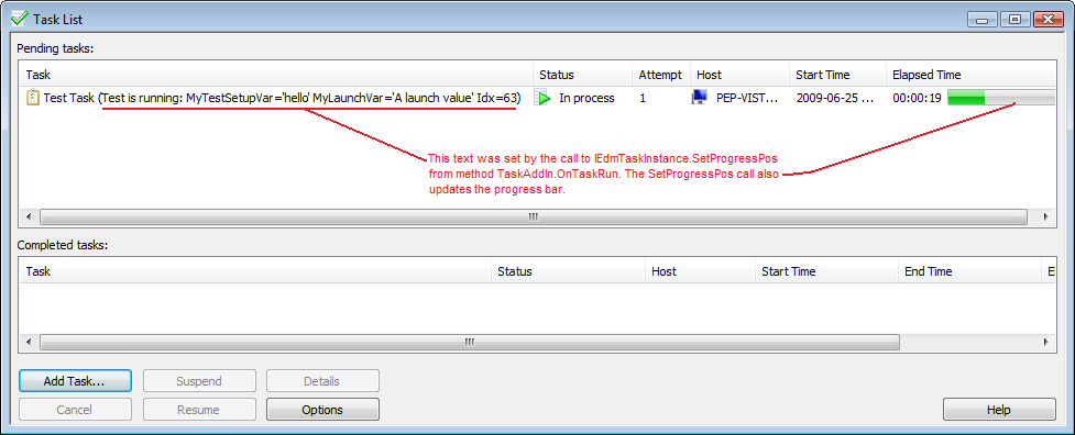

Private Sub OnTaskRun(ByRef poCmd As EdmCmd, ByRef ppoData As System.Array)
  'Get the property interface used to access the framework
  On Error GoTo ErrHand
  'Inform the framework that the task has started
  inst.SetStatus(EdmTaskStatus.EdmTaskStat_Running)
  'Format a message to be displayed in the task list
  Dim msg As String
  msg = "Test is running:"
  msg = msg + " MyTestSetupVar='" + CStr(inst.GetValEx("MyTestSetupVar"))
  msg = msg + "' MyLaunchVar='" + inst.GetValEx("MyLaunchVar")
  msg = msg + "' Idx="
  'This is the main worker loop that does all of the important work;
  'it just beeps and sleeps
  Dim idx As Integer
  idx = 1
  Dim maxPos As Integer
  maxPos = 200
  inst.SetProgressRange(maxPos, 0, msg + CStr(idx))
  While idx < maxPos
    'Update progress bar that shows in the task list
    inst.SetProgressPos(idx, msg + CStr(idx))
    idx = idx + 1
    'Do some important work here
    System.Media.SystemSounds.Beep.Play()
    System.Threading.Thread.Sleep(60000 / maxPos)
    'Handle the cancel button in the task list
    If inst.GetStatus() = EdmTaskStatus.EdmTaskStat_CancelPending Then
      inst.SetStatus(EdmTaskStatus.EdmTaskStat_DoneCancelled)
      Exit Sub
    End If
    'Handle temporary suspension of the task
    If inst.GetStatus() = EdmTaskStatus.EdmTaskStat_SuspensionPending Then
      inst.SetStatus(EdmTaskStatus.EdmTaskStat_Suspended)
      While inst.GetStatus() = EdmTaskStatus.EdmTaskStat_Suspended
        System.Threading.Thread.Sleep(1000)
      End While
      If inst.GetStatus() = EdmTaskStatus.EdmTaskStat_ResumePending Then
      End If
    End If
  End While
  'Inform the framework that the task has successfully
completed
  inst.SetStatus(EdmTaskStatus.EdmTaskStat_DoneOK)
  Exit Sub
ErrHand:
  'Return errors to the framework by failing the task
  inst.SetStatus(EdmTaskStatus.EdmTaskStat_DoneFailed, Err.Number, "The test task failed!")
End Sub

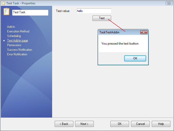

  'Add a custom setup page; SetupPage is a user control with an
  'edit box; SetupPage::LoadData populates the edit box from a
  'variable in IEdmTaskProperties; saving of properties is handled
  'by OnTaskSetupButton
  currentSetupPage = New SetupPage
  currentSetupPage.CreateControl()
  currentSetupPage.LoadData(poCmd)
  Dim pages(0) As EdmTaskSetupPage
  pages(0).mbsPageName = "Test Add-in page"
  pages(0).mlPageHwnd = currentSetupPage.Handle.ToInt32
  pages(0).mpoPageImpl = currentSetupPage
  props.SetSetupPages(pages)
End Sub

The following is a resource template of the custom set-up page that is displayed in the Task property dialog box by TaskAddIn::OnTaskSetup. It is a user control in Visual Studio with an edit box named TextBox1 and a button named TestButton.
The code behind the custom set-up page is as follows.
Imports EdmLib
Public Class SetupPage
'Button handler for a button on the page
Private Sub TestButton_Click(ByVal sender As System.Object, ByVal e As System.EventArgs) Handles TestButton.Click
  MsgBox("You pressed the test button")
End Sub
Public Sub LoadData(ByRef poCmd As EdmCmd)
  Dim props As IEdmTaskProperties
  props = poCmd.mpoExtra
  'Populate the edit box from a variable
TextBox1.Text = props.GetValEx("MyTestSetupVar")
End Sub
Public Sub StoreData(ByRef poCmd As EdmCmd)
  'Make sure the user has typed a value in the edit box
  If TextBox1.Text = "" Then
    MsgBox("Enter a test value for the add-in!")
    poCmd.mbCancel = True
    Exit Sub
  End If
  'Save the value entered by the user
  props.SetValEx("MyTestSetupVar", TextBox1.Text)
End Sub
End Class

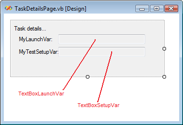

The following is the resource template of the extra details page added by TaskAddIn::OnTaskDetails. It is a user control in Visual Studio that displays two task variables:
The code behind the extra details page:
Imports EdmLib
Public Class TaskDetailsPage
Public Sub LoadData(ByRef inst As IEdmTaskInstance)
  'Populate the editboxes from the variables in the task
  TextBoxSetupVar.Text = CStr(inst.GetValEx("MyTestSetupVar"))
  TextBoxLaunchVar.Text = CStr(inst.GetValEx("MyLaunchVar"))
End Sub
End Class
The following is the set-up page when the add-in is used in a task.
The following is the task details page when opened from the task list.
The following is the task list during task execution.
