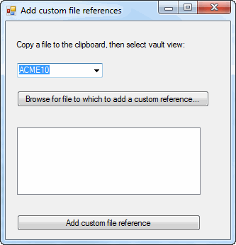

// Preconditions:
// 1. Start Microsoft Visual Studio 2010.
// a. Click File > New > Project > Visual
C# > Windows Forms Application.
// b. Type CustRefCSharp in Name.
// c. Click Browse and navigate to the folder where to create
// the project.
// d. Click OK.
// e. Click Show All Files in the Solution Explorer toolbar and expand
// Form1.cs in the Solution Explorer.
// f. Create a form similar to the form shown above and change:
// 1. Top label to VaultsLabel.
// 2. Combo box to VaultsComboBox.
// 3. Browse button to BrowseButton.
// 4. List box to CustRefListBox.
// 5. Add custom file reference button to AddCustomFileReference.
// g. Replace the code in Form1.cs with this code.
// h. Replace the code in Form1.Designer.cs with this code.
// 2. Add EPDM.Interop.epdm.dll as a reference (right-click the project
// name in the Solution Explorer, click Add Reference, click
// Assemblies > Framework in the left-side panel, browse to the top folder of
// your SOLIDWORKS PDM Professional installation, locate and click
// EPDM.Interop.epdm.dll, click Open, click Add, and click Close).
// 3. Right-click EPDM.Interop.epdm in References, click Properties, and set
// Embed Interop Types to False to handle methods that pass arrays of
// structures.
// 4. Click Debug > Start Debugging or press F5.
// Postconditions:
// 1. The Add custom references dialog displays.
// 2. Select a vault.
// 3. Click Browse for file to which to add custom reference,
// locate and click a file in the vault, and click Open.
// The file is checked out.
// 4. In a view of the selected vault, right-click a file and click Copy.
// 5. In the
Add custom references dialog, click Add custom file reference.
// The file that was copied to the clipboard is added as a custom
// reference to the checked-out file.
// 6. In the Create File References dialog, click OK.
// The file is checked in.
// 7. In the Edit User-Defined File References dialog, click OK.
// 8. Close the Add custom references dialog.

this.VaultsLabel = new System.Windows.Forms.Label();
this.VaultsComboBox = new System.Windows.Forms.ComboBox();
this.BrowseButton = new System.Windows.Forms.Button();
this.CustRefListBox = new System.Windows.Forms.ListBox();
this.AddCustomFileReference = new System.Windows.Forms.Button();
this.CustRefOpenFileDialog = new System.Windows.Forms.OpenFileDialog();
this.SuspendLayout();
// VaultsLabel
this.VaultsLabel.AutoSize = true;
this.VaultsLabel.Location = new System.Drawing.Point(13, 26);
this.VaultsLabel.Name = "VaultsLabel";
this.VaultsLabel.Size = new System.Drawing.Size(244, 13);
this.VaultsLabel.TabIndex = 0;
this.VaultsLabel.Text = "Copy a file to the clipboard, then select vault view:";
// VaultsComboBox
this.VaultsComboBox.FormattingEnabled = true;
this.VaultsComboBox.Location = new System.Drawing.Point(16, 59);
this.VaultsComboBox.Name = "VaultsComboBox";
this.VaultsComboBox.Size = new System.Drawing.Size(121, 21);
this.VaultsComboBox.TabIndex = 1;
// BrowseButton
this.BrowseButton.Location = new System.Drawing.Point(16, 98);
this.BrowseButton.Name = "BrowseButton";
this.BrowseButton.Size = new System.Drawing.Size(271, 23);
this.BrowseButton.TabIndex = 3;
this.BrowseButton.Text = "Browse for file to which to add a custom reference...";
this.BrowseButton.UseVisualStyleBackColor = true;
this.BrowseButton.Click += new System.EventHandler(this.BrowseButton_Click);
// CustRefListBox
this.CustRefListBox.FormattingEnabled = true;
this.CustRefListBox.Location = new System.Drawing.Point(16, 150);
this.CustRefListBox.Name = "CustRefListBox";
this.CustRefListBox.Size = new System.Drawing.Size(259, 95);
this.CustRefListBox.TabIndex = 4;
// AddCustomFileReference
this.AddCustomFileReference.Location = new System.Drawing.Point(16, 273);
this.AddCustomFileReference.Name = "AddCustomFileReference";
this.AddCustomFileReference.Size = new System.Drawing.Size(259, 23);
this.AddCustomFileReference.TabIndex = 5;
this.AddCustomFileReference.Text = "Add custom file reference";
this.AddCustomFileReference.UseVisualStyleBackColor = true;
this.AddCustomFileReference.Click += new System.EventHandler(this.AddCustomFileReference_Click);
// Form1
this.AutoScaleDimensions = new System.Drawing.SizeF(6F, 13F);
this.AutoScaleMode = System.Windows.Forms.AutoScaleMode.Font;
this.ClientSize = new System.Drawing.Size(317, 308);
this.Controls.Add(this.AddCustomFileReference);
this.Controls.Add(this.CustRefListBox);
this.Controls.Add(this.BrowseButton);
this.Controls.Add(this.VaultsComboBox);
this.Controls.Add(this.VaultsLabel);
this.Name = "Form1";
this.Text = "Add custom file references";
this.Load += new System.EventHandler(this.FileReferencesCSharp_Load);
this.ResumeLayout(false);
this.PerformLayout();
#endregion
private System.Windows.Forms.Label VaultsLabel;
private System.Windows.Forms.ComboBox VaultsComboBox;
private System.Windows.Forms.Button BrowseButton;
private System.Windows.Forms.ListBox CustRefListBox;
private System.Windows.Forms.Button AddCustomFileReference;
private System.Windows.Forms.OpenFileDialog CustRefOpenFileDialog;
