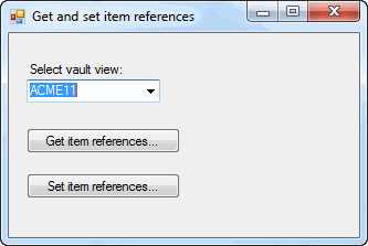

' 1. Displays the Get and set item references dialog box.
' 2. Select a vault view.
' 3. Click Get item references
'    a. Click an item folder in the vault.
'    b. Click OK.
'    c. Displays a message box confirming your folder selection.
'    d. Click OK.
'    e. Displays a message box with item references for the first item found
'       in the selected folder.
'    f. Click OK.
' 4. Click Set item references.
'    a. Click one or more files to add as references to the item.
'    b. Click Open.
'    c. Displays a message box with the updated references.
'       - or -
'       Displays a message box with errors.
'    d. Click OK.
' 5. Close the Get and set item references dialog box.

        Me.OpenFileDialog = New System.Windows.Forms.OpenFileDialog()
        Me.Button1 = New System.Windows.Forms.Button()
        Me.SuspendLayout()
        'VaultsLabel
        Me.VaultsLabel.AutoSize = True
        Me.VaultsLabel.Location = New System.Drawing.Point(13, 26)
        Me.VaultsLabel.Name = "VaultsLabel"
        Me.VaultsLabel.Size = New System.Drawing.Size(94, 13)
        Me.VaultsLabel.TabIndex = 0
        Me.VaultsLabel.Text = " Select vault view:"
        'VaultsComboBox
        Me.VaultsComboBox.FormattingEnabled = True
        Me.VaultsComboBox.Location = New System.Drawing.Point(16, 42)
        Me.VaultsComboBox.Name = "VaultsComboBox"
        Me.VaultsComboBox.Size = New System.Drawing.Size(121, 21)
        Me.VaultsComboBox.TabIndex = 1
        'GetItemRefs
        Me.GetItemRefs.Location = New System.Drawing.Point(16, 86)
        Me.GetItemRefs.Name = "GetItemRefs"
        Me.GetItemRefs.Size = New System.Drawing.Size(139, 23)
        Me.GetItemRefs.TabIndex = 5
        Me.GetItemRefs.Text = "Get item references..."
        Me.GetItemRefs.UseVisualStyleBackColor = True
        'OpenFileDialog
        Me.OpenFileDialog.Title = "Open"
        'Button1
        Me.Button1.Location = New System.Drawing.Point(16, 127)
        Me.Button1.Name = "Button1"
        Me.Button1.Size = New System.Drawing.Size(139, 23)
        Me.Button1.TabIndex = 6
        Me.Button1.Text = "Set item references..."
        Me.Button1.UseVisualStyleBackColor = True
        'Form1
        Me.AutoScaleDimensions = New System.Drawing.SizeF(6.0!, 13.0!)
        Me.AutoScaleMode = System.Windows.Forms.AutoScaleMode.Font
        Me.ClientSize = New System.Drawing.Size(317, 185)
        Me.Controls.Add(Me.Button1)
        Me.Controls.Add(Me.GetItemRefs)
        Me.Controls.Add(Me.VaultsComboBox)
        Me.Controls.Add(Me.VaultsLabel)
        Me.Name = "Form1"
        Me.Text = "Get and set item references"
        Me.ResumeLayout(False)
        Me.PerformLayout()
