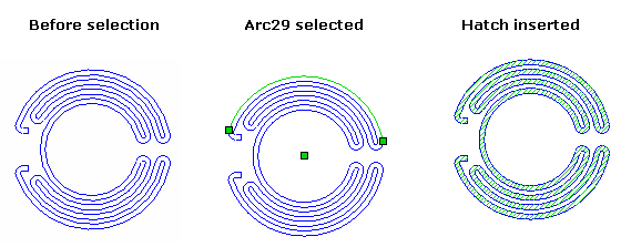

This example shows how to insert a hatch on a closed sketch in a drawing. The following image demonstrates the example.

boolstatus = Part.Extension.SelectByID2("Arc29", "SKETCHSEGMENT", 0.08421725979537, 0.08635799134766, 0, False, 0, Nothing, 0)
Dim selSkSeg As SldWorks.SketchSegment
Dim selSk As SldWorks.Sketch
Set selSkSeg = SelMgr.GetSelectedObject6(1, -1)
Set selSk = selSkSeg.GetSketch
Part.InsertHatchedFace
