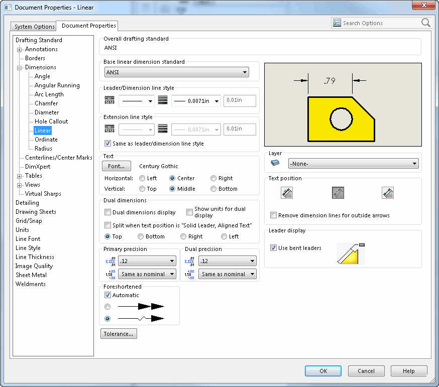

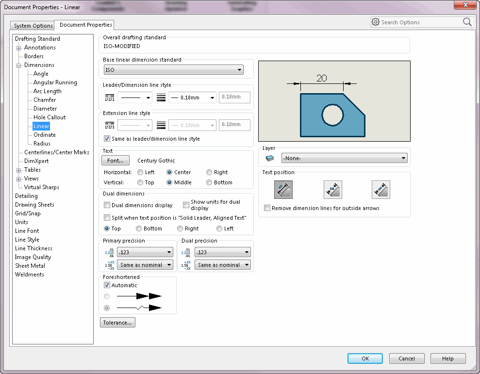

Document Properties > Dimensions > Linear
This topic contains two tables. The information in the table:
  • appearing immediately after the screen capture of the Document Properties - Linear dialog corresponds to the settings on that dialog.
  • titled Obsolete Enumerators contains enumerators that previously appeared on the Document Properties - Linear dialog, but are now obsolete and no longer appear on that dialog.
Setting
Get/Set Methods
Return Value or <Value>
Comments
Enumerator
Comment
swDetailingDimANSIBentLeader
Obsolete
