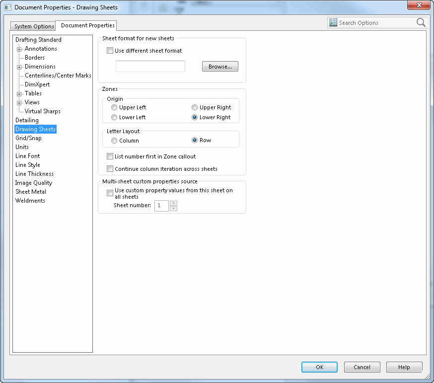

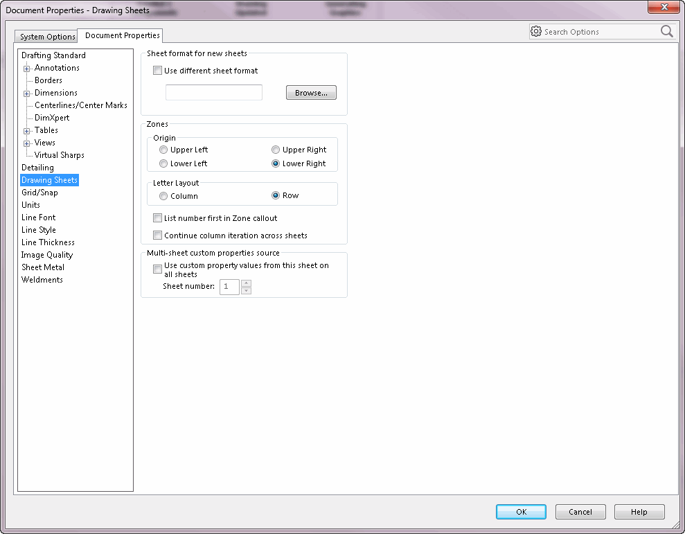

Document Properties > Drawing Sheets
Setting
Get/Set Methods
Return Value or <Value>
Comments
Sheet format for new sheets - Use different sheet format
IModelDocExtension::GetUserPreferenceToggle(swUserPreferenceToggle_e.swDrawingSheetUseDifferentSheetFormat, swUserPreferenceOption_e.swDetailingNoOptionSpecified)
IModelDocExtension::SetUserPreferenceToggle(swUserPreferenceToggle_e.swDrawingSheetUseDifferentSheetFormat, swUserPreferenceOption_e.swDetailingNoOptionSpecified, <Value>)
Boolean value
Specifies whether to use a different sheet format
Sheet format for new sheets - Sheet format file location
IModelDocExtension::GetUserPreferenceString(swUserPreferenceStringValue_e.swFileLocationsNewSheetFormat, swUserPreferenceOption_e.swDetailingNoOptionSpecified)
IModelDocExtension::SetUserPreferenceString(swUserPreferenceStringValue_e.swFileLocationsNewSheetFormat, swUserPreferenceOption_e.swDetailingNoOptionSpecified, <Value>)
String value
Specifies the location of the sheet format file to use
Zones - Origin
IModelDocExtension::GetUserPreferenceInteger(swUserPreferenceIntegerValue_e.swDrawingSheetsZonesOrigin, swUserPreferenceOption_e.swDetailingNoOptionSpecified)
IModelDocExtension::SetUserPreferenceInteger(swUserPreferenceIntegerValue_e.swDrawingSheetsZonesOrigin, swUserPreferenceOption_e.swDetailingNoOptionSpecified, swDrawingSheetsZonesOrigin_e.<Value>)
See swDrawingSheetsZonesOrigin_e for valid options
Specifies the corner where the lowest letters and numbers start on the drawing sheet
Zones - Letter Layout
IModelDocExtension::GetUserPreferenceToggle(swUserPreferenceToggle_e.swDrawingSheetsZonesLetterLayout, swUserPreferenceOption_e.swDetailingNoOptionSpecified)
IModelDocExtension::SetUserPreferenceToggle(swUserPreferenceToggle_e.swDrawingSheetsZonesLetterLayout, swUserPreferenceOption_e.swDetailingNoOptionSpecified, swDrawingSheetsZonesLetterLayout_e.<Value>)
See swDrawingSheetsZonesLetterLayout_e for valid options
Specifies where the letters and numbers appear on the drawing sheet
Zones - List number first in Zone callout
IModelDocExtension::GetUserPreferenceToggle(swUserPreferenceToggle_e.swDrawingSheetsListNumFirstInZoneCallout, swUserPreferenceOption_e.swDetailingNoOptionSpecified)
IModelDocExtension::SetUserPreferenceToggle(swUserPreferenceToggle_e.swDrawingSheetsListNumFirstInZoneCallout, swUserPreferenceOption_e.swDetailingNoOptionSpecified, <Value>
Boolean value
Specifies whether to list letter or number as first character in zone callouts:
  • Letter first (A1, B3, C4, etc.); default
  • Number first (1A, 3B, 4C, etc.)
Zones - Continue column iteration across sheets
IModelDocExtension::GetUserPreferenceToggle(swUserPreferenceToggle_e.swDrawingSheetsContinueColumnIteration, swUserPreferenceOption_e.swDetailingNoOptionSpecified)
IModelDocExtension::SetUserPreferenceToggle(swUserPreferenceToggle_e.swDrawingSheetsContinueColumnIteration, swUserPreferenceOption_e.swDetailingNoOptionSpecified, <Value>)
Boolean value
Specifies whether to restart columns or rows (default) across drawing sheets; (i.e., A, B, C, etc.)
Multi-sheet custom properties source - Use custom property values from this sheet on all sheets
IModelDocExtension::GetUserPreferenceToggle(swUserPreferenceToggle_e.swDrawingSheetsMatchCustomPropVals, swUserPreferenceOption_e.swDetailingNoOptionSpecified)
IModelDocExtension::SetUserPreferenceToggle(swUserPreferenceToggle_e.swDrawingSheetsMatchCustomPropVals, swUserPreferenceOption_e.swDetailingNoOptionSpecified, <Value>)
Boolean value
Specifies whether to use custom property values from this sheet on all sheets
Multi-sheet custom properties source - Sheet number
IModelDocExtension::GetUserPreferenceInteger(swUserPreferenceIntegerValue_e.swDrawingSheetCustomPropSheetNo, swUserPreferenceOption_e.swDetailingNoOptionSpecified)
IModelDocExtension::SetUserPreferenceInteger(swUserPreferenceIntegerValue_e.swDrawingSheetCustomPropSheetNo, swUserPreferenceOption_e.swDetailingNoOptionSpecified, <Value>)
Integer value
Sheet number
