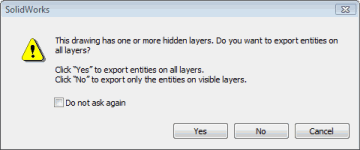

  • titled Hidden Layers Dialog Enumerators contains enumerators corresponding to options on the hidden layers warning dialog that pops up during export to DXF/DWG of drawings that have one or more hidden layers.

Do you want to export entities on all layers? <Yes/No>
ISldWorks::GetUserPreferenceToggle(swUserPreferenceToggle_e.swDXFExportHiddenLayersOn)
ISldWorks::SetUserPreferenceToggle(swUserPreferenceToggle_e.swDXFExportHiddenLayersOn, <OnFlag>)
Boolean value
Specifies whether to export layers that are hidden in the drawing
Do not ask again
ISldWorks::GetUserPreferenceToggle(swUserPreferenceToggle_e.swDXFExportHiddenLayersWarnIsOn)
ISldWorks::SetUserPreferenceToggle(swUserPreferenceToggle_e.swDXFExportHiddenLayersWarnIsOn, <OnFlag>)
Boolean value
Specifies whether to dismiss the hidden layers warning dialog on export; restore the dismissed dialog in System Options > Advanced
