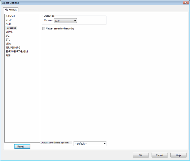

File > Save As > Save as type > Parasolid > Options
Setting
Get/Set Methods
Return Value
or
<Value>
or
<OnFlag>
Comment
Output as - Version
ISldWorks::GetUserPreferenceIntegerValue(swUserPreferenceIntegerValue_e.swParasolidOutputVersion)
ISldWorks::SetUserPreferenceIntegerValue(swUserPreferenceIntegerValue_e.swParasolidOutputVersion, swParasolidOutputVersion_e.<Value>)
See swParasolidOutputVersion_e for valid options
Flatten assembly hierarchy
ISldWorks::GetUserPreferenceToggle(swUserPreferenceToggle_e.swXTAssemSaveFormat)
ISldWorks::SetUserPreferenceToggle(swUserPreferenceToggle_e.swXTAssemSaveFormat, <OnFlag>)
Boolean value
Specifies whether to flatten assembly hierarchy in Parasolid output; for assemblies only
Output coordinate system
IModelDocExtension::GetUserPreferenceString(swUserPreferenceString_e.swFileSaveAsCoordinateSystem, swUserPreferenceOption_e.swDetailingNoOptionSpecified)
IModelDocExtension::SetUserPreferenceString(swUserPreferenceString_e.swFileSaveAsCoordinateSystem, swUserPreferenceOption_e.swDetailingNoOptionSpecified, <Value>)
String value
Contains the name of the transform coordinate system; an empty string signifies that the  default coordinate system that does not require a transform; coordinate settings are not saved with the document; they must be selected at export time
