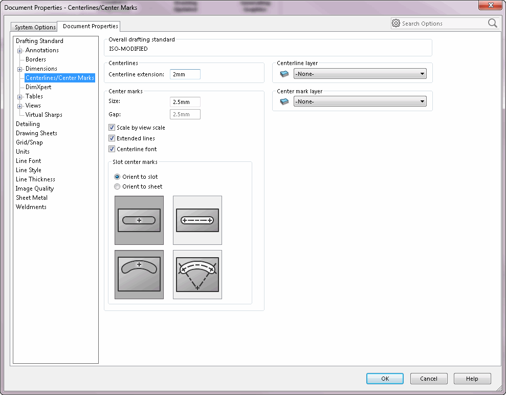

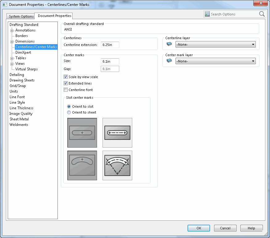

Document Properties > Centerlines/Center Marks
Setting
Get/Set Methods
Return Value or <Value>
Comments
Centerlines - Centerline extension
IModelDocExtension::GetUserPreferenceDouble(swUserPreferenceDoubleValue_e.swDetailingCenterlineExtension, swUserPreferenceOption_e.swDetailingNoOptionSpecified)
IModelDocExtension::SetUserPreferenceDouble(swUserPreferenceDoubleValue_e.swDetailingCenterlineExtension, swUserPreferenceOption_e.swDetailingNoOptionSpecified, <Value>)
Double value in meters
Specifies length to extend the centerline beyond section geometry when in a drawing view
Center marks - Size
IModelDocExtension::GetUserPreferenceDouble(swUserPreferenceDoubleValue_e.swDetailingCenterMarkSize, swUserPreferenceOption_e.swDetailingNoOptionSpecified)
IModelDocExtension::SetUserPreferenceDouble(swUserPreferenceDoubleValue_e.swDetailingCenterMarkSize, swUserPreferenceOption_e.swDetailingNoOptionSpecified, <Value>)
Specifies the size of center marks in drawings
Center marks - Gap
IModelDocExtension::GetUserPreferenceDouble(swUserPreferenceDoubleValue_e.swDetailingCenterMarkGap, swUserPreferenceOption_e.swDetailingNoOptionSpecified)
IModelDocExtension::SetUserPreferenceDouble(swUserPreferenceDoubleValue_e.swDetailingCenterMarkGap, swUserPreferenceOption_e.swDetailingNoOptionSpecified, <Value>)
Specifies the center mark gap size
Center marks - Scale by view scale
IModelDocExtension::GetUserPreferenceToggle(swUserPreferenceToggle_e.swDetailingCenterMarkScaleByViewScale, swUserPreferenceOption_e.swDetailingNoOptionSpecified)
IModelDocExtension::SetUserPreferenceToggle(swUserPreferenceToggle_e.swDetailingCenterMarkScaleByViewScale, swUserPreferenceOption_e.swDetailingNoOptionSpecified, <Value>)
Boolean value
Specifies whether to scale center marks by the view scale
Center marks - Extended lines
IModelDocExtension::GetUserPreferenceToggle(swUserPreferenceToggle_e.swDetailingCenterMarkShowLines, swUserPreferenceOption_e.swDetailingNoOptionSpecified)
IModelDocExtension::SetUserPreferenceToggle(swUserPreferenceToggle_e.swDetailingCenterMarkShowLines, swUserPreferenceOption_e.swDetailingNoOptionSpecified, <Value>)
Boolean value
Specifies whether to display center mark extension lines
Center marks - Centerline font
IModelDocExtension::GetUserPreferenceToggle(swUserPreferenceToggle_e.swDetailingCenterMarkUseCenterLine, swUserPreferenceOption_e.swDetailingNoOptionSpecified)
IModelDocExtension::SetUserPreferenceToggle(swUserPreferenceToggle_e.swDetailingCenterMarkUseCenterLine, swUserPreferenceOption_e.swDetailingNoOptionSpecified, <Value>)
Boolean value
Specifies whether lines in center marks use font specified for centerlines
Slot center marks - Orient to slot or Orient to sheet
IModelDocExtension::GetUserPreferenceInteger(swUserPreferenceIntegerValue_e.swCenterLineMarkOrient, swUserPreferenceOption_e.swDetailingNoOptionSpecified)
IModelDocExtension::SetUserPreferenceInteger(swUserPreferenceIntegerValue_e.swCenterLineMarkOrient, swUserPreferenceOption_e.swDetailingNoOptionSpecified, swCenterLineMarkOrient_e.<Value>)
See swCenterLineMarkOrient_e for valid options
Specifies the orientation of the centerline marks
Slot center marks - Place mark at centers of straight slots
IModelDocExtension::GetUserPreferenceToggle(swUserPreferenceToggle_e.swCenterLineMarkLinear, swUserPreferenceOption_e.swDetailingNoOptionSpecified)
IModelDocExtension::SetUserPreferenceToggle(swUserPreferenceToggle_e.swCenterLineMarkLinear, swUserPreferenceOption_e.swDetailingNoOptionSpecified, <Value>)
Boolean value
Specifies placement of marks at centers of straight slots
Slot center marks - Place mark at ends of straight slots
IModelDocExtension::GetUserPreferenceToggle(swUserPreferenceToggle_e.swCenterLineMarkEndsOnlyLinear, swUserPreferenceOption_e.swDetailingNoOptionSpecified)
IModelDocExtension::SetUserPreferenceToggle(swUserPreferenceToggle_e.swCenterLineMarkEndsOnlyLinear, swUserPreferenceOption_e.swDetailingNoOptionSpecified, <Value>)
Boolean value
Specifies placement of marks at ends of straight slots; only available with Slot center marks - Orient to slot option
Slot center marks - Place mark at centers of arc slots
IModelDocExtension::GetUserPreferenceToggle(swUserPreferenceToggle_e.swCenterLineMarkCircular, swUserPreferenceOption_e.swDetailingNoOptionSpecified)
IModelDocExtension::SetUserPreferenceToggle(swUserPreferenceToggle_e.swCenterLineMarkCircular, swUserPreferenceOption_e.swDetailingNoOptionSpecified, <Value>)
Boolean value
Specifies placement of marks at centers of arc slots
Slot center marks - Place mark at ends of arc slots
IModelDocExtension::GetUserPreferenceToggle(swUserPreferenceToggle_e.swCenterLineMarkEndsOnlyCircular, swUserPreferenceOption_e.swDetailingNoOptionSpecified)
IModelDocExtension::SetUserPreferenceToggle(swUserPreferenceToggle_e.swCenterLineMarkEndsOnlyCircular, swUserPreferenceOption_e.swDetailingNoOptionSpecified, <Value>)
Boolean value
Specifies placement of marks at ends of arc slots; only available with Slot center marks - Orient to slot option
Centerline layer
IModelDocExtension::GetUserPreferenceString(swUserPreferenceStringValue_e.swCenterLineLayer, swUserPreferenceOption_e.swDetailingNoOptionSpecified)
IModelDocExtension::SetUserPreferenceString(swUserPreferenceStringValue_e.swCenterLineLayer, swUserPreferenceOption_e.swDetailingNoOptionSpecified, <Value>)
Valid Options:
  • "Border"
  • "Dimensions"
  • "Notes"
  • "BOM"
  • "FORMAT"
Depending on the drawing, some options may not apply
Center mark layer
IModelDocExtension::GetUserPreferenceString(swUserPreferenceStringValue_e.swCenterMarkLayer, swUserPreferenceOption_e.swDetailingNoOptionSpecified)
IModelDocExtension::SetUserPreferenceString(swUserPreferenceStringValue_e.swCenterMarkLayer, swUserPreferenceOption_e.swDetailingNoOptionSpecified, <Value>)
Valid Options:
  • "Border"
  • "Dimensions"
  • "Notes"
  • "BOM"
  • "FORMAT"
Depending on drawing, some options may not apply
