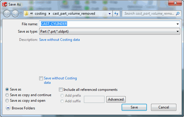

Save without Costing data
IModelDocExtension::GetUserPreferenceToggle(swUserPreferenceToggle_e.swSaveWithoutCostingData, swUserPreferenceOption_e.swDetailingNoOptionSpecified)
IModelDocExtension::SetUserPreferenceToggle(swUserPreferenceToggle_e.swSaveWithoutCostingData, swUserPreferenceOption_e.swDetailingNoOptionSpecified, <OnFlag>)
Boolean value
Specifies whether to save the sheet metal part without including any Costing data

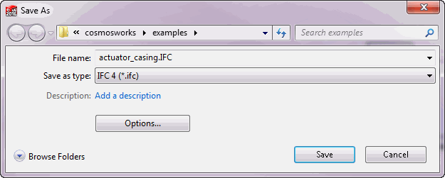

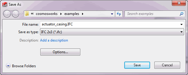

Save as type - IFC 2x3 or IFC 4
ISldWorks::GetUserPreferenceIntegerValue(swUserPreferenceIntegerValue_e.swSaveIFCFormat)
ISldWorks::SetUserPreferenceIntegerValue(swUserPreferenceIntegerValue_e.swSaveIFCFormat, <Value>)
  • 23 = IFC 2x3
  • 4 = IFC 4
Specifies the IFC format in which to save a part
