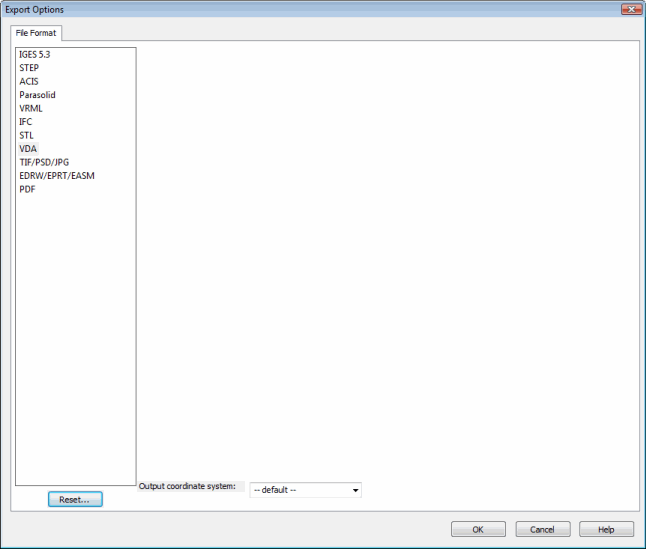

File > Save As > Save as type > VDAFS > Options
Setting
Get/Set Methods
Return Value
or
<Value>
Comment
Output coordinate system
IModelDocExtension::GetUserPreferenceString(swUserPreferenceString_e.swFileSaveAsCoordinateSystem, swUserPreferenceOption_e.swDetailingNoOptionSpecified)
IModelDocExtension::SetUserPreferenceString(swUserPreferenceString_e.swFileSaveAsCoordinateSystem, swUserPreferenceOption_e.swDetailingNoOptionSpecified, <Value>)
String value
Contains the name of the transform coordinate system; an empty string signifies that the  default coordinate system that does not require a transform; coordinate settings are not saved with the document; they must be selected at export time
