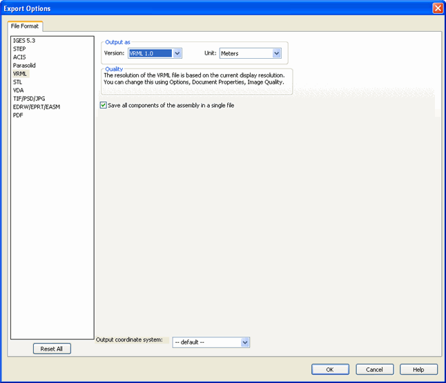

File > Save As > Save as type > VRML > Options
Setting
Get/Set Methods
Return Value
or
<Value>
or
<OnFlag>
Comment
Output as - Version
ISldWorks::GetUserPreferenceIntegerValue(swUserPreferenceIntegerValue_e.swExportVrmlVersion)
ISldWorks::SetUserPreferenceIntegerValue(swUserPreferenceIntegerValue_e.swExportVrmlVersion, swVrmlOutputVersion_e.<Value>)
Values as defined in swVrmlOutputVersion_e
Output as - Unit
ISldWorks::GetUserPreferenceIntegerValue(swUserPreferenceIntegerValue_e.swExportVrmlUnits)
ISldWorks::SetUserPreferenceIntegerValue(swUserPreferenceIntegerValue_e.swExportVrmlUnits, swLengthUnit_e.<Value>)
Any of the following swLengthUnit_e values:
  • 0 = swMM (millimeters)
  • 1 = swCM (centimeters)
  • 2 = swMETER
  • 3 = swINCHES
  • 4 = swFEET
Save all components of the assembly in a single file
ISldWorks::GetUserPreferenceToggle(swUserPreferenceToggle_e.swExportVrmlAllComponentsInSingleFile)
ISldWorks::SetUserPreferenceToggle(swUserPreferenceToggle_e.swExportVrmlAllComponentsInSingleFile, <OnFlag>)
Boolean value
Specifies whether to save all of the components of an assembly to a single VRML (.wrl) file
Output coordinate system
IModelDocExtension::GetUserPreferenceString(swUserPreferenceString_e.swFileSaveAsCoordinateSystem, swUserPreferenceOption_e.swDetailingNoOptionSpecified)
IModelDocExtension::SetUserPreferenceString(swUserPreferenceString_e.swFileSaveAsCoordinateSystem, swUserPreferenceOption_e.swDetailingNoOptionSpecified, <Value>)
String value
Contains the name of the transform coordinate system; an empty string signifies that the default coordinate system does not require a transform; coordinate settings are not saved with the document; they must be selected at export time
