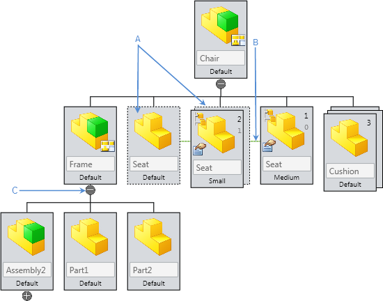

Additional User Interface Elements
A Suppressed instances.
B Different configurations of the same component.
C Expands or collapses child components. Shift+click to expand or collapse all child components, including subassemblies.
