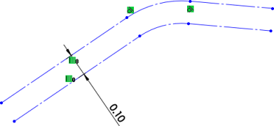

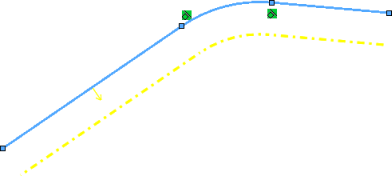

You can create offset geometry as construction geometry while using the Offset Entities tool.
Previously, you could only convert the base geometry to construction geometry.
To access
Base geometry and
Offset geometry construction geometry options, select a sketch entity and click
Construction Geometry option for Offset geometry |
Construction Geometry for Base geometry and Offset geometry |
