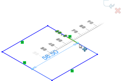

- View the dimension handles or Instant2D Rulers
while selecting dimensions in sketch mode.

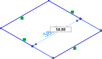

- Edit dimensions for any dimension type in the dimension input value box by clicking a dimension value.

Instant2D Rulers |
Dimension input value box |
