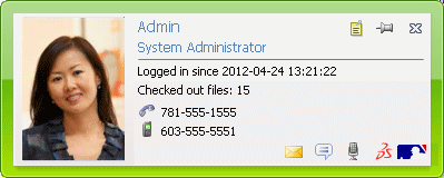

User pop-up windows are visible in Windows Explorer and SOLIDWORKS views of a SOLIDWORKS PDM vault.
To view user pop-ups in Windows Explorer:
Navigate to SOLIDWORKS PDM vault that has files checked out.
- Hover over a user name in the Checked Out By column.
- To pin the card so it remains displayed, click
- To close a pinned card, click
.Administrators can configure to hide a user pop-up window in the Administration tool.
