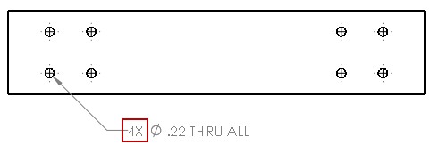

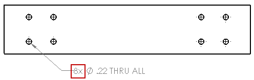

Hole Callout Instance Count for Mirrored Holes
When you use the Hole Callout tool on a hole pattern that includes a mirror on the same body, the instance count includes the mirrored holes.
SOLIDWORKS 2017
SOLIDWORKS 2016
