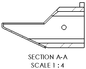

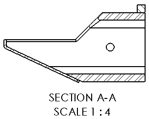

Scale Hatch Pattern is available for section views and drawing views that include broken-out section views.
| Scale Hatch Pattern selected |
Scale Hatch Pattern cleared |
When you select Scale Hatch Pattern in the Section View PropertyManager, hatches within this view apply the view’s scale to the hatch pattern. Previously, only detail views had this option.
