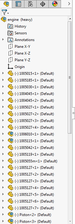

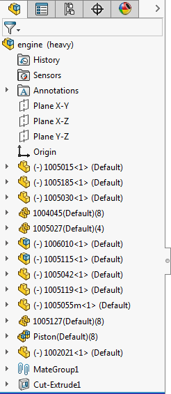

In the FeatureManager design tree, you can automatically group the same components with the same configuration into a folder-like structure.
Grouping can greatly condense the length of the FeatureManager design tree and make it easier to find components, especially in large assemblies.
In the FeatureManager design tree, right-click the top-level assembly and click .
| Ungrouped components |
Grouped components |
