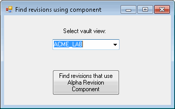

Find Revisions Using Component Example (C#)
This example shows how to find the revision numbers using the revision number component named Alpha Revision Component.

//  6. Create a form similar to the form shown above and change:
//     a. Label to VaultsLabel.
//     b. Combo box to VaultsComboBox
//     c. Button to FindRevisionsButton.

//  1. Displays a dialog.
//  2. Select a vault.
//  3. Click the Find revisions that use Alpha Revision Component button.
//  4. Prints the names of the revision numbers using the revision number
//     component Alpha Revision Component to the Immediate window.
//  5. Examine the Immediate window.
//  6. Close the dialog.
