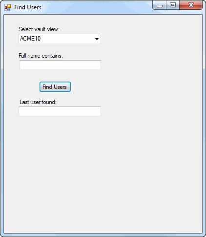

// Postconditions:
//  1. Displays the Find Users dialog box.
//     a. Select a vault view.
//     b. In Full name contains, type a substring of the full name of a
//        user that exists in the vault.
//     c. Click Find Users.
//        A message box confirms the substring typed in Postconditions
//        step 1b.
//     d. Click OK.
//        Displays a Search for users dialog.
//     e. Click Find.
//        Displays a Search for users dialog with results.
//     f. Click the first row.
//     g. Click Select.
//        * Displays a message box with the updated user information.
//        * The selected user's phone and website information are updated.
//     h. Click OK.
//  2. Updates the Find Users dialog box with the full name and picture,
//     if it exists, of the last user found whose full name contains the substring
//     typed in Postconditions step 1b.
//  3. Close the Find Users dialog box.
