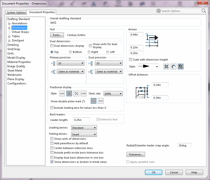

Setting |
Get/Set Methods |
Return Value or <Value> |
Comments |
Text - Font... |
IModelDocExtension::GetUserPreferenceTextFormat(swUserPreferenceTextFormat_e.swDetailingDimensionTextFormat,
swUserPreferenceOption_e.swDetailingDimension)
IModelDocExtension::SetUserPreferenceTextFormat(swUserPreferenceTextFormat_e.swDetailingDimensionTextFormat,
swUserPreferenceOption_e.swDetailingDimension, <Value>) |
See ITextFormat
for font options |
To set font property values, implement ITextFormat, set the appropriate
ITextFormat member values, and pass the ITextFormat object in the API
set method |
Dual dimensions - Dual dimensions display |
IModelDocExtension::GetUserPreferenceToggle(swUserPreferenceToggle_e.swDetailingDualDimensions,
IModelDocExtension::SetUserPreferenceToggle(swUserPreferenceToggle_e.swDetailingDualDimensions,
Boolean value |
Specifies whether to display dimensions in two kinds of units |
Dual dimensions - Show units for dual display |
IModelDocExtension::GetUserPreferenceToggle(swUserPreferenceToggle_e.swDetailingShowUnitsForDualDisplay,
IModelDocExtension::SetUserPreferenceToggle(swUserPreferenceToggle_e.swDetailingShowUnitsForDualDisplay,
Boolean value |
Specifies whether to display units for dual dimensions |
Dual dimensions - Dimension Position |
IModelDocExtension::GetUserPreferenceInteger(swUserPreferenceIntegerValue_e.swDetailingDualDimPosition,
IModelDocExtension::SetUserPreferenceInteger(swUserPreferenceIntegerValue_e.swDetailingDualDimPosition,
swUserPreferenceOption_e.swDetailingDimension, swDetailingDualDimPosition_e.<Value>) |
See swDetailingDualDimPosition_e
for valid options |
Positions the display of dimensions in two kinds of units |
Primary precision - Unit Precision |
IModelDocExtension::GetUserPreferenceInteger(swUserPreferenceIntegerValue_e.swDetailingLinearDimPrecision,
IModelDocExtension::SetUserPreferenceInteger(swUserPreferenceIntegerValue_e.swDetailingLinearDimPrecision,
Number of decimal places to display; 0 through 8 |
Specifies primary precision for linear dimension |
Primary precision - Tolerance Precision |
IModelDocExtension::GetUserPreferenceInteger(swUserPreferenceIntegerValue_e.swDetailingLinearTolPrecision,
IModelDocExtension::SetUserPreferenceInteger(swUserPreferenceIntegerValue_e.swDetailingLinearTolPrecision,
swUserPreferenceOption_e.swDetailingDimension, swDimensionPrecisionSettings_e
.<Value>) |
See swDimensionPrecisionSettings_e
for valid options |
Specifies primary precision for linear tolerance |
Primary precision - Link precisions with model |
IModelDocExtension::GetUserPreferenceToggle(swUserPreferenceToggle_e.swDetailingLinearDimPrecisionLinkWithModel,
IModelDocExtension::SetUserPreferenceToggle(swUserPreferenceToggle_e.swDetailingLinearDimPrecisionLinkWithModel,
Boolean value |
Dual precision - Unit Precision |
IModelDocExtension::GetUserPreferenceInteger(swUserPreferenceIntegerValue_e.swDetailingAltLinearDimPrecision,
IModelDocExtension::SetUserPreferenceInteger(swUserPreferenceIntegerValue_e.swDetailingAltLinearDimPrecision,
Specifies dual precision for alternate linear dimension |
Dual precision - Tolerance Precision |
IModelDocExtension::GetUserPreferenceInteger(swUserPreferenceIntegerValue_e.swDetailingAltLinearTolPrecision,
IModelDocExtension::SetUserPreferenceInteger(swUserPreferenceIntegerValue_e.swDetailingAltLinearTolPrecision,
.<Value>) |
for valid options |
Specifies dual precision for alternate linear tolerance |
Dual precision - Link precisions with model |
IModelDocExtension::GetUserPreferenceToggle(swUserPreferenceToggle_e.swDetailingAltLinearDimPrecisionLinkWithModel,
IModelDocExtension::SetUserPreferenceToggle(swUserPreferenceToggle_e.swDetailingAltLinearDimPrecisionLinkWithModel,
Boolean value |
Fractional display - Style |
IModelDocExtension::GetUserPreferenceInteger(swUserPreferenceIntegerValue_e.swDetailingDimFractionStyle,
swUserPreferenceOption_e.swDetailingNoOptionSpecified)
IModelDocExtension::SetUserPreferenceInteger(swUserPreferenceIntegerValue_e.swDetailingDimFractionStyle,
swUserPreferenceOption_e.swDetailingNoOptionSpecified, swDetailingDimFractionStyle_e.<Value>) |
See swDetailingDimFractionStyle_e
for valid options |
Fractional display - Stack size |
IModelDocExtension::GetUserPreferenceInteger(swUserPreferenceIntegerValue_e.swDetailingDimFractionScaleIndex,
IModelDocExtension::SetUserPreferenceInteger(swUserPreferenceIntegerValue_e.swDetailingDimFractionScaleIndex,
swUserPreferenceOption_e.swDetailingNoOptionSpecified, swDetailingDimFractionScaleIndex_e.<Value>) |
See swDetailingDimFractionScaleIndex_e
for valid options |
Fractional display - Show double prime mark('') |
IModelDocExtension::GetUserPreferenceToggle(swUserPreferenceToggle_e.swDoublePrimeMark,
IModelDocExtension::SetUserPreferenceToggle(swUserPreferenceToggle_e.swDoublePrimeMark,
swUserPreferenceOption_e.swDetailingNoOptionSpecified, <Value>) |
Boolean value |
Specifies whether to show the double prime mark ('') in a fractional
display |
Fractional display - Include leading
zero for values less than 1" |
IModelDocExtension::GetUserPreferenceToggle(swUserPreferenceToggle_e.swDetailingDimsShowLeadingZeros,
IModelDocExtension::SetUserPreferenceToggle(swUserPreferenceToggle_e.swDetailingDimsShowLeadingZeros,
Boolean value |
Specifies whether to show leading
zero for values less than 1" in a fractional display |
Bent leaders - Leader length |
IModelDocExtension::GetUserPreferenceDouble(swUserPreferenceDoubleValue_e.swDetailingDimBentLeaderLength,
IModelDocExtension::SetUserPreferenceDouble(swUserPreferenceDoubleValue_e.swDetailingDimBentLeaderLength,
Double value in meters |
Specifies bent leader length |
Leading zeroes |
IModelDocExtension::GetUserPreferenceInteger(swUserPreferenceIntegerValue_e.swDetailingLeadingZero,
IModelDocExtension::SetUserPreferenceInteger(swUserPreferenceIntegerValue_e.swDetailingLeadingZero,
swUserPreferenceOption_e.swDetailingNoOptionSpecified, swDetailingLeadingZero_e.<Value>) |
See swDetailingLeadingZero_e
for valid options |
Trailing zeroes |
IModelDocExtension::GetUserPreferenceInteger(swUserPreferenceIntegerValue_e.swDetailingDimTrailingZero,
IModelDocExtension::SetUserPreferenceInteger(swUserPreferenceIntegerValue_e.swDetailingDimTrailingZero,
swUserPreferenceOption_e.swDetailingNoOptionSpecified, swDetailingDimTrailingZero_e.<Value>) |
See swDetailingDimTrailingZero_e
for valid options |
Show units of dimensions |
IModelDocExtension::GetUserPreferenceToggle(swUserPreferenceToggle_e.swDetailingShowDimensionUnits,
IModelDocExtension::SetUserPreferenceToggle(swUserPreferenceToggle_e.swDetailingShowDimensionUnits,
Boolean value |
Specifies whether to show dimension
units |
Add parentheses by default |
IModelDocExtension::GetUserPreferenceToggle(swUserPreferenceToggle_e.swDetailingDimsShowParenthesisByDefault,
IModelDocExtension::SetUserPreferenceToggle(swUserPreferenceToggle_e.swDetailingDimsShowParenthesisByDefault,
Boolean value |
Specifies whether to show reference dimensions within parentheses in
drawings |
Center between extension lines |
IModelDocExtension::GetUserPreferenceToggle(swUserPreferenceToggle_e.swDetailingDimsCenterText,
IModelDocExtension::SetUserPreferenceToggle(swUserPreferenceToggle_e.swDetailingDimsCenterText,
Boolean value |
Specifies whether to center dimension text between extension lines |
Include prefix inside basic tolerance box |
IModelDocExtension::GetUserPreferenceToggle(swUserPreferenceToggle_e.swDetailingDimsPrefixInsideBasicTolBox,
IModelDocExtension::SetUserPreferenceToggle(swUserPreferenceToggle_e.swDetailingDimsPrefixInsideBasicTolBox,
Boolean value |
Specifies whether to include prefix inside basic tolerance box |
Display dual basic dimension in one box |
IModelDocExtension::GetUserPreferenceToggle(swUserPreferenceToggle_e.swDetailingDisplayDualBasicDimensionInOneBox,
IModelDocExtension::SetUserPreferenceToggle(swUserPreferenceToggle_e.swDetailingDisplayDualBasicDimensionInOneBox,
Boolean value |
Specifies whether to display dual basic dimensions in one box |
Show dimensions as broken in break views |
IModelDocExtension::GetUserPreferenceToggle(swUserPreferenceToggle_e.swDetailingDimsShowBroken,
IModelDocExtension::SetUserPreferenceToggle(swUserPreferenceToggle_e.swDetailingDimsShowBroken,
Boolean value |
Specifies whether to show dimensions as broken in break views |
Apply updated rules |
IModelDocExtension::GetUserPreferenceToggle(swUserPreferenceToggle_e.swDetailingDimsApplyUpdatedRules,
IModelDocExtension::SetUserPreferenceToggle(swUserPreferenceToggle_e.swDetailingDimsApplyUpdatedRules,
Boolean value |
Specifies whether to apply updated rules |
Radial/Diameter leader snap angle |
IModelDocExtension::GetUserPreferenceDouble(swUserPreferenceDoubleValue_e.swDetailingDimRadialSnapAngle,
IModelDocExtension::SetUserPreferenceDouble(swUserPreferenceDoubleValue_e.swDetailingDimRadialSnapAngle,
Double value between 0 and 90 |
Specifies radial leader snap angle. |
Tolerance... |
See Comments |
See Comments |
See Dimension Tolerance |
Arrows - Width |
IModelDocExtension::GetUserPreferenceDouble(swUserPreferenceDoubleValue_e.swDetailingArrowWidth,
IModelDocExtension::SetUserPreferenceDouble(swUserPreferenceDoubleValue_e.swDetailingArrowWidth,
Specifies width of arrowheads |
Arrows - Height |
IModelDocExtension::GetUserPreferenceDouble(swUserPreferenceDoubleValue_e.swDetailingArrowHeight,
IModelDocExtension::SetUserPreferenceDouble(swUserPreferenceDoubleValue_e.swDetailingArrowHeight,
Specifies length of arrowheads |
Arrows - Length |
IModelDocExtension::GetUserPreferenceDouble(swUserPreferenceDoubleValue_e.swDetailingArrowLength,
IModelDocExtension::SetUserPreferenceDouble(swUserPreferenceDoubleValue_e.swDetailingArrowLength,
Specifies length of arrows |
Arrows - Scale with dimension height |
IModelDocExtension::GetUserPreferenceToggle(swUserPreferenceToggle_e.swDetailingScaleWithDimHeight,
IModelDocExtension::SetUserPreferenceToggle(swUserPreferenceToggle_e.swDetailingScaleWithDimHeight,
Boolean value |
Specifies whether to scale the arrow head to the height of the dimension
text |
Arrows - Style |
IModelDocExtension::GetUserPreferenceInteger(swUserPreferenceIntegerValue_e.swDetailingArrowStyleForDimensions,
IModelDocExtension::SetUserPreferenceInteger(swUserPreferenceIntegerValue_e.swDetailingArrowStyleForDimensions,
swUserPreferenceOption_e.swDetailingNoOptionSpecified, swArrowStyle_e.<Value>) |
See swArrowStyle_e
for valid options |
Specifies the default style of dimension arrows |
Arrows - Position |
IModelDocExtension::GetUserPreferenceInteger(swUserPreferenceIntegerValue_e.swDetailingDimensionArrowPosition,
IModelDocExtension::SetUserPreferenceInteger(swUserPreferenceIntegerValue_e.swDetailingDimensionArrowPosition,
swUserPreferenceOption_e.swDetailingNoOptionSpecified, swDimensionArrowsSide_e.<Value>) |
See swDimensionArrowsSide_e
for valid options |
Specifies position of arrows |
Offset distances - Annotation view layout |
See Comments |
See Comments |
Not currently available in SOLIDWORKS API |
Offset distances - Dimension to dimension offset |
IModelDocExtension::GetUserPreferenceDouble(swUserPreferenceDoubleValue_e.swDetailingDimToDimOffset,
IModelDocExtension::SetUserPreferenceDouble(swUserPreferenceDoubleValue_e.swDetailingDimToDimOffset,
Specifies distance between dimension lines for baseline dimensions and
Align Parallel/Concentric; offset distance for dimensions displayed with
tolerances automatically doubled |
Offset distances - Object to dimension offset |
IModelDocExtension::GetUserPreferenceDouble(swUserPreferenceDoubleValue_e.swDetailingObjectToDimOffset,
IModelDocExtension::SetUserPreferenceDouble(swUserPreferenceDoubleValue_e.swDetailingObjectToDimOffset,
Specifies distance between model and first dimension for baseline dimensions
but not for Align Parallel/Concentric |
Break dimension extension/leader lines - Gap |
IModelDocExtension::GetUserPreferenceDouble(swUserPreferenceDoubleValue_e.swDetailingDimBreakGap,
IModelDocExtension::SetUserPreferenceDouble(swUserPreferenceDoubleValue_e.swDetailingDimBreakGap,
For drawings only; Specifies dimension's gap in extension and leader
lines when they are broken |
Break dimension extension/leader lines - Break only around dimension
arrows |
IModelDocExtension::GetUserPreferenceToggle(swUserPreferenceToggle_e.swDetailingDimBreakAroundArrow,
IModelDocExtension::SetUserPreferenceToggle(swUserPreferenceToggle_e.swDetailingDimBreakAroundArrow,
Boolean value |
For drawings only; Specifies whether to have breaks occur only where
lines cross arrow |
Extension lines - Gap |
IModelDocExtension::GetUserPreferenceDouble(swUserPreferenceDoubleValue_e.swDetailingWitnessLineGap,
IModelDocExtension::SetUserPreferenceDouble(swUserPreferenceDoubleValue_e.swDetailingWitnessLineGap,
For drawings only; Specifies the distance between the model and dimension
extension lines |
Extension lines - Beyond dimension line |
IModelDocExtension::GetUserPreferenceDouble(swUserPreferenceDoubleValue_e.swDetailingWitnessLineExtension,
IModelDocExtension::SetUserPreferenceDouble(swUserPreferenceDoubleValue_e.swDetailingWitnessLineExtension,
For drawings only; Specifies length of the extension line beyond dimension
line |
