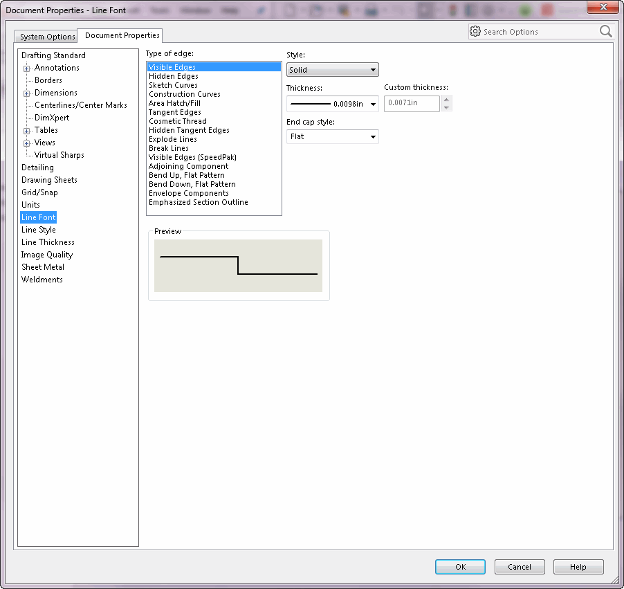

Setting |
Get/Set Methods |
Return Value or <Value> |
Comments |
Visible Edges - Style |
IModelDocExtension::GetUserPreferenceInteger(swUserPreferenceIntegerValue_e.swLineFontVisibleEdgesStyle,
swUserPreferenceOption_e.swDetailingNoOptionSpecified)
IModelDocExtension::SetUserPreferenceInteger(swUserPreferenceIntegerValue_e.swLineFontVisibleEdgesStyle,
swUserPreferenceOption_e.swDetailingNoOptionSpecified, swLineStyles_e.<Value>) |
See swLineStyles_e
for valid options |
Specifies style of visible edges |
Visible Edges - Thickness |
IModelDocExtension::GetUserPreferenceInteger(swUserPreferenceIntegerValue_e.swLineFontVisibleEdgesThickness,
IModelDocExtension::SetUserPreferenceInteger(swUserPreferenceIntegerValue_e.swLineFontVisibleEdgesThickness,
swUserPreferenceOption_e.swDetailingNoOptionSpecified, swLineWeights_e.<Value>) |
See swLineWeights_e
for valid options |
Specifies thickness of visible edges |
Visible Edges - Custom thickness |
IModelDocExtension::GetUserPreferenceDouble(swUserPreferenceDoubleValue_e.swLineFontVisibleEdgesThicknessCustom,
IModelDocExtension::SetUserPreferenceDouble(swUserPreferenceDoubleValue_e.swLineFontVisibleEdgesThicknessCustom,
swUserPreferenceOption_e.swDetailingNoOptionSpecified, <Value>) |
Double value |
Specifies a custom thickness for visible edges |
Visible Edges - End cap style |
IModelDocExtension::GetUserPreferenceInteger(swUserPreferenceIntegerValue_e.swLineFontVisibleEdgesEndCap,
IModelDocExtension::SetUserPreferenceInteger(swUserPreferenceIntegerValue_e.swLineFontVisibleEdgesEndCap,
swUserPreferenceOption_e.swDetailingNoOptionSpecified, swLineEndCaps_e.<Value>) |
See swLineEndCaps_e
for valid options |
Specifies style of visible edge end caps |
Hidden Edges - Style |
IModelDocExtension::GetUserPreferenceInteger(swUserPreferenceIntegerValue_e.swLineFontHiddenEdgesStyle,
IModelDocExtension::SetUserPreferenceInteger(swUserPreferenceIntegerValue_e.swLineFontHiddenEdgesStyle,
See swLineStyles_e
for valid options |
Specifies style of hidden edges |
Hidden Edges - Thickness |
IModelDocExtension::GetUserPreferenceInteger(swUserPreferenceIntegerValue_e.swLineFontHiddenEdgesThickness,
IModelDocExtension::SetUserPreferenceInteger(swUserPreferenceIntegerValue_e.swLineFontHiddenEdgesThickness,
See swLineWeights_e
for valid options |
Specifies thickness of hidden edges |
Hidden Edges - Custom thickness |
IModelDocExtension::GetUserPreferenceDouble(swUserPreferenceDoubleValue_e.swLineFontHiddenEdgesThicknessCustom,
IModelDocExtension::SetUserPreferenceDouble(swUserPreferenceDoubleValue_e.swLineFontHiddenEdgesThicknessCustom,
Double value |
Specifies a custom thickness for hidden edges |
Hidden Edges - End cap style |
IModelDocExtension::GetUserPreferenceInteger(swUserPreferenceIntegerValue_e.swLineFontHiddenEdgesEndCap,
IModelDocExtension::SetUserPreferenceInteger(swUserPreferenceIntegerValue_e.swLineFontHiddenEdgesEndCap,
See swLineEndCaps_e
for valid options |
Specifies style of hidden edge end caps |
Sketch Curves - Style |
IModelDocExtension::GetUserPreferenceInteger(swUserPreferenceIntegerValue_e.swLineFontSketchCurvesStyle,
IModelDocExtension::SetUserPreferenceInteger(swUserPreferenceIntegerValue_e.swLineFontSketchCurvesStyle,
See swLineStyles_e
for valid options |
Specifies style of sketch curves |
Sketch Curves - Thickness |
IModelDocExtension::GetUserPreferenceInteger(swUserPreferenceIntegerValue_e.swLineFontSketchCurvesThickness,
IModelDocExtension::SetUserPreferenceInteger(swUserPreferenceIntegerValue_e.swLineFontSketchCurvesThickness,
See swLineWeights_e
for valid options |
Specifies thickness of sketch curves |
Sketch Curves - Custom thickness |
IModelDocExtension::GetUserPreferenceDouble(swUserPreferenceDoubleValue_e.swLineFontSketchCurvesThicknessCustom,
IModelDocExtension::SetUserPreferenceDouble(swUserPreferenceDoubleValue_e.swLineFontSketchCurvesThicknessCustom,
Double value |
Specifies a custom thickness for sketch curves |
Sketch Curves - End cap style |
IModelDocExtension::GetUserPreferenceInteger(swUserPreferenceIntegerValue_e.swLineFontSketchCurvesEndCap,
IModelDocExtension::SetUserPreferenceInteger(swUserPreferenceIntegerValue_e.swLineFontSketchCurvesEndCap,
See swLineEndCaps_e
for valid options |
Specifies style of sketch curve end caps |
Construction Curves - Style |
IModelDocExtension::GetUserPreferenceInteger(swUserPreferenceIntegerValue_e.swLineFontConstructionCurvesStyle,
IModelDocExtension::SetUserPreferenceInteger(swUserPreferenceIntegerValue_e.swLineFontConstructionCurvesStyle,
See swLineStyles_e
for valid options |
Specifies style of construction curves |
Construction Curves - Thickness |
IModelDocExtension::GetUserPreferenceInteger(swUserPreferenceIntegerValue_e.swLineFontConstructionCurvesThickness,
IModelDocExtension::SetUserPreferenceInteger(swUserPreferenceIntegerValue_e.swLineFontConstructionCurvesThickness,
See swLineWeights_e
for valid options |
Specifies thickness of construction curves |
Construction Curves - Custom thickness |
IModelDocExtension::GetUserPreferenceDouble(swUserPreferenceDoubleValue_e.swLineFontConstructionCurvesThicknessCustom,
IModelDocExtension::SetUserPreferenceDouble(swUserPreferenceDoubleValue_e.swLineFontConstructionCurvesThicknessCustom,
Double value |
Specifies a custom thickness for construction curves |
Area Hatch/Fill - Style |
IModelDocExtension::GetUserPreferenceInteger(swUserPreferenceIntegerValue_e.swLineFontCrosshatchStyle,
IModelDocExtension::SetUserPreferenceInteger(swUserPreferenceIntegerValue_e.swLineFontCrosshatchStyle,
See swLineStyles_e
for valid options |
Specifies style of hatch/fills |
Area Hatch/Fill - Thickness |
IModelDocExtension::GetUserPreferenceInteger(swUserPreferenceIntegerValue_e.swLineFontCrosshatchThickness,
IModelDocExtension::SetUserPreferenceInteger(swUserPreferenceIntegerValue_e.swLineFontCrosshatchThickness,
See swLineWeights_e
for valid options |
Specifies thickness of hatch/fills |
Area Hatch/Fill - Custom thickness |
IModelDocExtension::GetUserPreferenceDouble(swUserPreferenceDoubleValue_e.swLineFontCrosshatchThicknessCustom,
IModelDocExtension::SetUserPreferenceDouble(swUserPreferenceDoubleValue_e.swLineFontCrosshatchThicknessCustom,
Double value |
Specifies a custom thickness for hatch/fills |
Tangent Edges - Style |
IModelDocExtension::GetUserPreferenceInteger(swUserPreferenceIntegerValue_e.swLineFontTangentEdgesStyle,
IModelDocExtension::SetUserPreferenceInteger(swUserPreferenceIntegerValue_e.swLineFontTangentEdgesStyle,
See swLineStyles_e
for valid options |
Specifies style of tangent edges |
Tangent Edges - Thickness |
IModelDocExtension::GetUserPreferenceInteger(swUserPreferenceIntegerValue_e.swLineFontTangentEdgesThickness,
IModelDocExtension::SetUserPreferenceInteger(swUserPreferenceIntegerValue_e.swLineFontTangentEdgesThickness,
See swLineWeights_e
for valid options |
Specifies thickness of tangent edges |
Tangent Edges - Custom thickness |
IModelDocExtension::GetUserPreferenceDouble(swUserPreferenceDoubleValue_e.swLineFontTangentEdgesThicknessCustom,
IModelDocExtension::SetUserPreferenceDouble(swUserPreferenceDoubleValue_e.swLineFontTangentEdgesThicknessCustom,
Double value |
Specifies a custom thickness for tangent edges |
Cosmetic Thread - Style |
IModelDocExtension::GetUserPreferenceInteger(swUserPreferenceIntegerValue_e.swLineFontCosmeticThreadStyle,
IModelDocExtension::SetUserPreferenceInteger(swUserPreferenceIntegerValue_e.swLineFontCosmeticThreadStyle,
See swLineStyles_e
for valid options |
Specifies style of cosmetic threads |
Cosmetic Thread - Thickness |
IModelDocExtension::GetUserPreferenceInteger(swUserPreferenceIntegerValue_e.swLineFontCosmeticThreadThickness,
IModelDocExtension::SetUserPreferenceInteger(swUserPreferenceIntegerValue_e.swLineFontCosmeticThreadThickness,
See swLineWeights_e
for valid options |
Specifies thickness of cosmetic threads |
Cosmetic Thread - Custom thickness |
IModelDocExtension::GetUserPreferenceDouble(swUserPreferenceDoubleValue_e.swLineFontCosmeticThreadThicknessCustom,
IModelDocExtension::SetUserPreferenceDouble(swUserPreferenceDoubleValue_e.swLineFontCosmeticThreadThicknessCustom,
Double value |
Specifies a custom thickness for cosmetic threads |
Hidden Tangent Edges - Style |
IModelDocExtension::GetUserPreferenceInteger(swUserPreferenceIntegerValue_e.swLineFontHideTangentEdgeStyle,
IModelDocExtension::SetUserPreferenceInteger(swUserPreferenceIntegerValue_e.swLineFontHideTangentEdgeStyle,
See swLineStyles_e
for valid options |
Specifies style of hidden tangent edges |
Hidden Tangent Edges - Thickness |
IModelDocExtension::GetUserPreferenceInteger(swUserPreferenceIntegerValue_e.swLineFontHideTangentEdgeThickness,
IModelDocExtension::SetUserPreferenceInteger(swUserPreferenceIntegerValue_e.swLineFontHideTangentEdgeThickness,
See swLineWeights_e
for valid options |
Specifies thickness of hidden tangent edges |
Hidden Tangent Edges - Custom thickness |
IModelDocExtension::GetUserPreferenceDouble(swUserPreferenceDoubleValue_e.swLineFontHideTangentEdgeThicknessCustom,
IModelDocExtension::SetUserPreferenceDouble(swUserPreferenceDoubleValue_e.swLineFontHideTangentEdgeThicknessCustom,
Double value |
Specifies a custom thickness for hidden tangent edges |
Explode Lines - Style |
IModelDocExtension::GetUserPreferenceInteger(swUserPreferenceIntegerValue_e.swLineFontExplodedLinesStyle,
IModelDocExtension::SetUserPreferenceInteger(swUserPreferenceIntegerValue_e.swLineFontExplodedLinesStyle,
See swLineStyles_e
for valid options |
Specifies style of exploded lines |
Explode Lines - Thickness |
IModelDocExtension::GetUserPreferenceInteger(swUserPreferenceIntegerValue_e.swLineFontExplodedLinesThickness,
IModelDocExtension::SetUserPreferenceInteger(swUserPreferenceIntegerValue_e.swLineFontExplodedLinesThickness,
See swLineWeights_e
for valid options |
Specifies thickness of exploded lines |
Explode Lines - Custom thickness |
IModelDocExtension::GetUserPreferenceDouble(swUserPreferenceDoubleValue_e.swLineFontExplodedLinesThicknessCustom,
IModelDocExtension::SetUserPreferenceDouble(swUserPreferenceDoubleValue_e.swLineFontExplodedLinesThicknessCustom,
Double value |
Specifies a custom thickness for exploded lines |
Break Lines - Style |
IModelDocExtension::GetUserPreferenceInteger(swUserPreferenceIntegerValue_e.swLineFontBreakLineStyle,
IModelDocExtension::SetUserPreferenceInteger(swUserPreferenceIntegerValue_e.swLineFontBreakLineStyle,
See swLineStyles_e
for valid options |
Specifies style of break lines |
Break Lines - Thickness |
IModelDocExtension::GetUserPreferenceInteger(swUserPreferenceIntegerValue_e.swLineFontBreakLineThickness,
IModelDocExtension::SetUserPreferenceInteger(swUserPreferenceIntegerValue_e.swLineFontBreakLineThickness,
See swLineWeights_e
for valid options |
Specifies thickness of break lines |
Break Lines - Custom thickness |
IModelDocExtension::GetUserPreferenceDouble(swUserPreferenceDoubleValue_e.swLineFontBreakLineThicknessCustom,
IModelDocExtension::SetUserPreferenceDouble(swUserPreferenceDoubleValue_e.swLineFontBreakLineThicknessCustom,
Double value |
Specifies a custom thickness for break lines |
Visible Edges (SpeedPak) - Style |
IModelDocExtension::GetUserPreferenceInteger(swUserPreferenceIntegerValue_e.swLineFontSpeedPakDrawingsModelEdgesStyle,
IModelDocExtension::SetUserPreferenceInteger(swUserPreferenceIntegerValue_e.swLineFontSpeedPakDrawingsModelEdgesStyle,
See swLineStyles_e
for valid options |
Specifies style of SpeedPak drawing model edges |
Visible Edges (SpeedPak) - Thickness |
IModelDocExtension::GetUserPreferenceInteger(swUserPreferenceIntegerValue_e.swLineFontSpeedPakDrawingsModelEdgesThickness,
IModelDocExtension::SetUserPreferenceInteger(swUserPreferenceIntegerValue_e.swLineFontSpeedPakDrawingsModelEdgesThickness,
See swLineWeights_e
for valid options |
Specifies thickness of SpeedPak drawing model edges |
Visible Edges (SpeedPak) - Custom thickness |
IModelDocExtension::GetUserPreferenceDouble(swUserPreferenceDoubleValue_e.swLineFontSpeedPakDrawingsModelEdgesThicknessCustom,
IModelDocExtension::SetUserPreferenceDouble(swUserPreferenceDoubleValue_e.swLineFontSpeedPakDrawingsModelEdgesThicknessCustom,
Double value |
Specifies a custom thickness for model edges in a SpeedPak drawing document |
Adjoining Component - Style |
ModelDocExtension::GetUserPreferenceInteger(swUserPreferenceIntegerValue_e.swLineFontAdjoiningComponentStyle,
IModelDocExtension::SetUserPreferenceInteger(swUserPreferenceIntegerValue_e.swLineFontAdjoiningComponentStyle,
See swLineStyles_e
for valid options |
Specifies style of the edges of
adjoining components in drawing documents |
Adjoining Component - Thickness |
ModelDocExtension::GetUserPreferenceInteger(swUserPreferenceIntegerValue_e.swLineFontAdjoiningComponent,
IModelDocExtension::SetUserPreferenceInteger(swUserPreferenceIntegerValue_e.swLineFontAdjoiningComponent,
See swLineWeights_e
for valid options |
Specifies thickness of the edges of
Adjoining Component - Custom
thickness |
IModelDocExtension::GetUserPreferenceDouble(swUserPreferenceDoubleValue_e.swLineFontAdjoiningComponentCustom,
IModelDocExtension::SetUserPreferenceDouble(swUserPreferenceDoubleValue_e.swLineFontAdjoiningComponentCustom,
Double value |
Specifies a custom thickness of the
edges of adjoining components in drawing documents |
Bend Up, Flat Pattern - Style |
ModelDocExtension::GetUserPreferenceInteger(swUserPreferenceIntegerValue_e.swLineFontBendLineUpStyle,
IModelDocExtension::SetUserPreferenceInteger(swUserPreferenceIntegerValue_e.swLineFontBendLineUpStyle,
See swLineStyles_e
for valid options |
Specifies style of the bend lines
indicating where to bend the sheet metal up in flat patterns in drawing documents |
Bend Up, Flat Pattern - Thickness |
ModelDocExtension::GetUserPreferenceInteger(swUserPreferenceIntegerValue_e.swLineFontBendLineUpThickness,
IModelDocExtension::SetUserPreferenceInteger(swUserPreferenceIntegerValue_e.swLineFontBendLineUpThickness,
See swLineWeights_e
for valid options |
Specifies thickness of the bend
lines indicating where to bend the sheet metal up in flat patterns in drawing documents |
Bend Up, Flat Pattern - Custom
thickness |
IModelDocExtension::GetUserPreferenceDouble(swUserPreferenceDoubleValue_e.swLineFontBendLineUpThicknessCustom,
IModelDocExtension::SetUserPreferenceDouble(swUserPreferenceDoubleValue_e.swLineFontBendLineUpThicknessCustom,
Double value |
bend lines indicating where to bend the sheet metal up in flat patterns in drawing documents
Bend Down, Flat Pattern - Style |
ModelDocExtension::GetUserPreferenceInteger(swUserPreferenceIntegerValue_e.swLineFontBendLineDownStyle,
IModelDocExtension::SetUserPreferenceInteger(swUserPreferenceIntegerValue_e.swLineFontBendLineDownStyle,
See swLineStyles_e
for valid options |
indicating where to bend the sheet metal down in flat patterns in drawing documents |
Bend Down, Flat Pattern - Thickness |
ModelDocExtension::GetUserPreferenceInteger(swUserPreferenceIntegerValue_e.swLineFontBendLineDownThickness,
IModelDocExtension::SetUserPreferenceInteger(swUserPreferenceIntegerValue_e.swLineFontBendLineDownThickness,
See swLineWeights_e
for valid options |
lines indicating where to bend the sheet metal down in flat patterns in drawing documents |
Bend Down, Flat Pattern - Custom
thickness |
IModelDocExtension::GetUserPreferenceDouble(swUserPreferenceDoubleValue_e.swLineFontBendLineDownThicknessCustom,
IModelDocExtension::SetUserPreferenceDouble(swUserPreferenceDoubleValue_e.swLineFontBendLineDownThicknessCustom,
Double value |
bend lines indicating where to bend the sheet metal down in flat patterns in drawing documents
Envelope Components - Style |
ModelDocExtension::GetUserPreferenceInteger(swUserPreferenceIntegerValue_e.swLineFontEnvelopeComponentStyle,
IModelDocExtension::SetUserPreferenceInteger(swUserPreferenceIntegerValue_e.swLineFontEnvelopeComponentStyle,
See swLineStyles_e
for valid options |
envelope components |
Envelope Components - Thickness |
ModelDocExtension::GetUserPreferenceInteger(swUserPreferenceIntegerValue_e.swLineFontEnvelopeComponentThickness,
IModelDocExtension::SetUserPreferenceInteger(swUserPreferenceIntegerValue_e.swLineFontEnvelopeComponentThickness,
See swLineWeights_e
for valid options |
Envelope Components - Custom
thickness |
IModelDocExtension::GetUserPreferenceDouble(swUserPreferenceDoubleValue_e.swLineFontEnvelopeComponentThicknessCustom,
IModelDocExtension::SetUserPreferenceDouble(swUserPreferenceDoubleValue_e.swLineFontEnvelopeComponentThicknessCustom,
Double value |
edges of envelope components |
Emphasized Section Outline - Style |
ModelDocExtension::GetUserPreferenceInteger(swUserPreferenceIntegerValue_e.swLineFontEmphasizedSectionOutlineStyle,
IModelDocExtension::SetUserPreferenceInteger(swUserPreferenceIntegerValue_e.swLineFontEmphasizedSectionOutlineStyle,
See swLineStyles_e
for valid options |
Specifies style of the outline of an emphasized section |
Emphasized Section Outline - Thickness |
IModelDocExtension::GetUserPreferenceDouble(swUserPreferenceDoubleValue_e.swLineFontEmphasizedSectionThickness,
IModelDocExtension::SetUserPreferenceDouble(swUserPreferenceDoubleValue_e.swLineFontEmphasizedSectionThickness,
See swLineWeights_e
for valid options |
Specifies the thickness of the outline of an emphasized section |
Emphasized Section Outline - Custom thickness |
IModelDocExtension::GetUserPreferenceDouble(swUserPreferenceDoubleValue_e.swLineFontEmphasizedSectionThicknessCustom,
IModelDocExtension::SetUserPreferenceDouble(swUserPreferenceDoubleValue_e.swLineFontEmphasizedSectionThicknessCustom,
Double value |
Emphasized Section Outline - End cap style |
IModelDocExtension::GetUserPreferenceInteger(swUserPreferenceIntegerValue_e.swLineFontEmphasizedSectionEndCapStyle,
IModelDocExtension::SetUserPreferenceInteger(swUserPreferenceIntegerValue_e.swLineFontEmphasizedSectionEndCapStyle,
See swLineEndCaps_e
for valid options |
Specifies style of emphasized section outline end caps |
