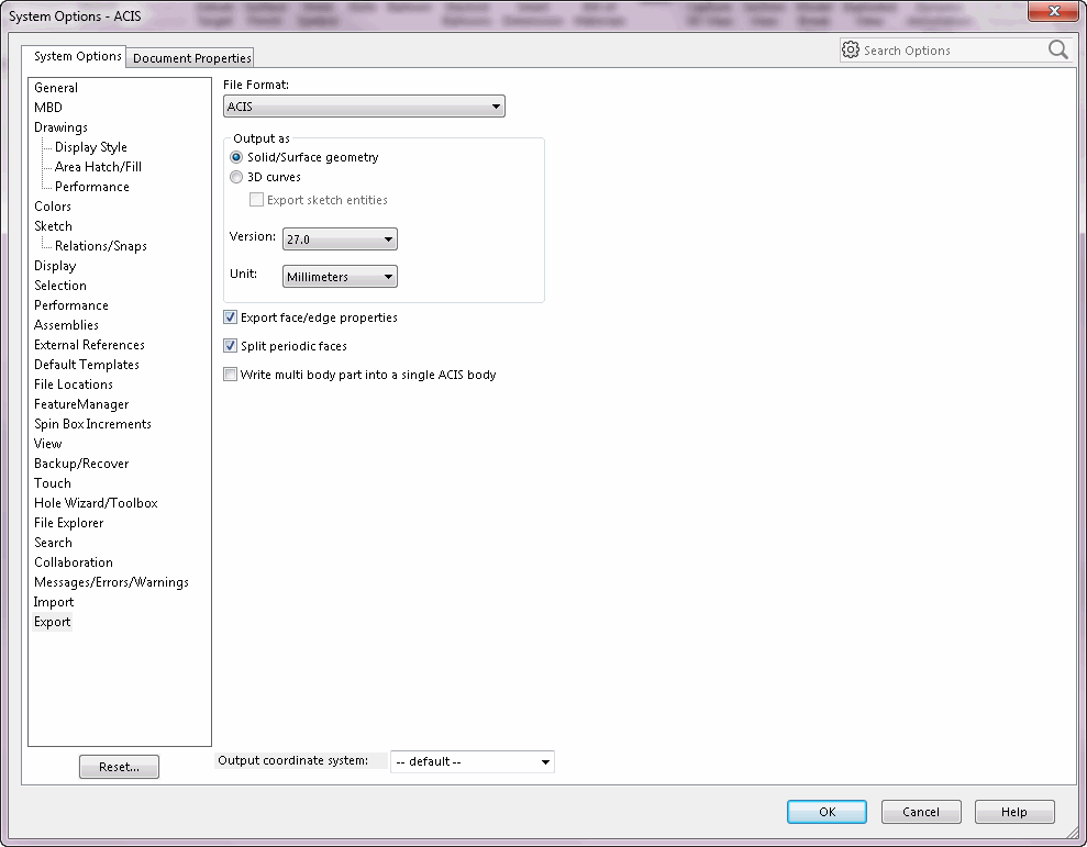

System Options > Export > ACIS
To display the dialog:
Click Tools > Options > System Options > Export > ACIS in File Format.
- or -
  1. Click File > Save As.
  2. In Save as type, select ACIS.
  3. Click Options.
Setting
Get/Set Methods
Return Value
or
<Value>
or
<OnFlag>
Comment
Output as - Solid/Surface geometry
ISldWorks::GetUserPreferenceIntegerValue(swUserPreferenceIntegerValue_e.swAcisOutputGeometryPreference)
ISldWorks::SetUserPreferenceIntegerValue(swUserPreferenceIntegerValue_e.swAcisOutputGeometryPreference, swAcisOutputGeometryPreference_e.swAcisOutputAsSolidAndSurface)
Output as - 3D curves
ISldWorks::SetUserPreferenceIntegerValue(swUserPreferenceIntegerValue_e.swAcisOutputGeometryPreference, swAcisOutputGeometryPreference_e.swAcisOutputAs3DCurves)
Output as - Export sketch entities
ISldWorks::SetUserPreferenceIntegerValue(swUserPreferenceIntegerValue_e.swAcisOutputGeometryPreference, swAcisOutputGeometryPreference_e.swAcisOutputAs3DCurves_IncludeSketchEnts)
Output as - Version
ISldWorks::GetUserPreferenceIntegerValue(swUserPreferenceIntegerValue_e.swAcisOutputVersion)
ISldWorks::SetUserPreferenceIntegerValue(swUserPreferenceIntegerValue_e.swAcisOutputVersion, swAcisOutputVersion_e.<Value>)
See swAcisOutputVersion_e for valid options
Output as - Unit
ISldWorks::GetUserPreferenceIntegerValue(swUserPreferenceIntegerValue_e.swAcisOutputUnits)
ISldWorks::SetUserPreferenceIntegerValue(swUserPreferenceIntegerValue_e.swAcisOutputUnits, swLengthUnit_e.<Value>)
See swLengthUnit_e for valid options
Export face/edge properties
ISldWorks::GetUserPreferenceToggle(swUserPreferenceToggle_e.swSATExportFaceEdgeProps)
ISldWorks::SetUserPreferenceToggle(swUserPreferenceToggle_e.swSATExportFaceEdgeProps, <OnFlag>)
Boolean value
Specifies whether to export face and edge properties
Split periodic faces
ISldWorks::GetUserPreferenceToggle(swUserPreferenceToggle_e.swSATExportSplitPeriodic)
ISldWorks::SetUserPreferenceToggle(swUserPreferenceToggle_e.swSATExportSplitPeriodic, <OnFlag>)
Boolean value
Specifies whether to split periodic faces on export
Write multi body part into a single ACIS body
ISldWorks::GetUserPreferenceToggle(swUserPreferenceToggle_e.swSATExportMultLumpsToSingleBody)
ISldWorks::SetUserPreferenceToggle(swUserPreferenceToggle_e.swSATExportMultLumpsToSingleBody, <OnFlag>)
Boolean value
