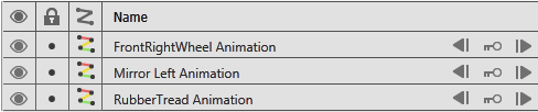

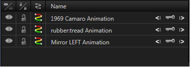

Show/Hide Animation |
Shows or hides the animation on the timeline. Hidden animations do not play back in realtime and do not render. |
Lock Animation |
Controls whether you can edit the animation. Editing is allowed when the animation is unlocked and prevented when it is locked .
Show/Hide Animation Ribbon in Viewport |
Shows or hides the Animation ribbon for the selected animation. For camera animations, the Animation ribbon is visible only if you view the scene through a different camera than the one you are animating. |
Name |
Displays animation name. Click the name to change it. |
Move to Previous Keyframe |
Moves the current time forward one keyframe. |
Create Keyframe at Current Time |
Adds a keyframe at the current time. |
Move to Next Keyframe |
Moves the current time backward one keyframe. |
